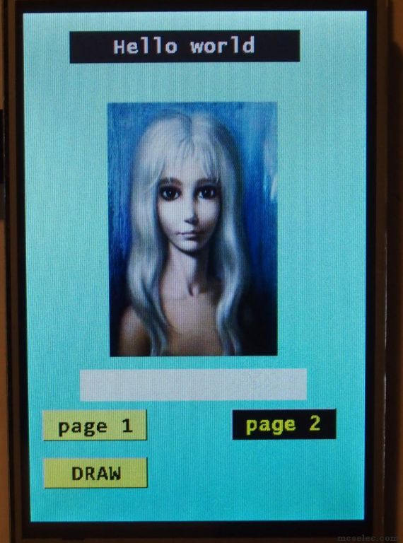

Hi
Nextion is a HMI system, more than a simple screen, it is both faster, draw its own user interfaces and all this with only 4 wires:
2 for power supply and 2 for serial communication.
In addition to Bascom, I have prepared a ".inc" file with all the sub and useful functions.
The video example shows only part of its possibilities
What impresses most is speed.

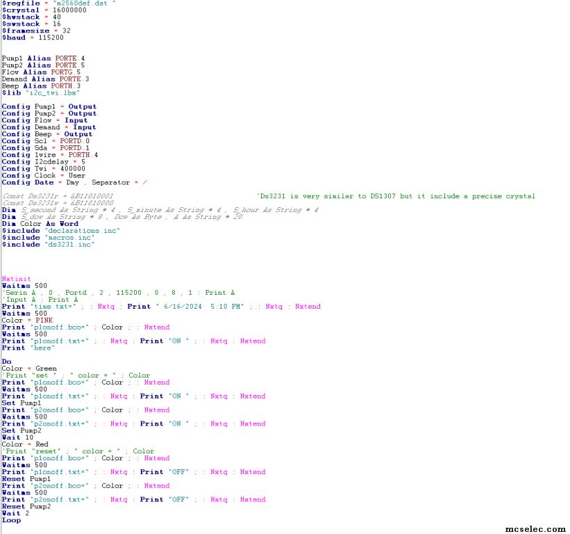

I have 7" K series Nextion and want to comunicate both ways. So I really appreciate your work that`s why I publish here how to parse data from Nextion.
I think this is better, non blocking solution Very Happy
Look how "Overlay" can be used multiple times on one buffer.
This example can be launched on Mega 2560. Nextion on Com2(RX1/TX1) rest like describes "#USB" it will be on RX0/TX0
$regfile = "m2560def.dat"                                   '8K SRAM | 4K EEPROM

PostPosted: Sat Jun 29, 2024 4:40 am    Post subject: problem with serial and ds3231 Reply with quote
hello i try to use on my program some of Duval JP code i am using bascom avr 2.0.8.6 when i use the include ds3231 the com port stop transmitting i try the code with 3 differed Arduino uno boards and with ATmega2560 board.
on ATmega2560 i have an error with the Const Pink = 65017 in declarations.inc the error is Error : 13 Line : 115 CONST already specified [PINK] , in File : declarations.inc
, if i remark this line i can compile the program with no errors but in the IDE when i use color=pink the word PINK is capitalized by the IDE and the color of the word pink is the same with the PORT.
i believe this is a bug the compiler think is the PIN[K] and not the color pink

and this is a print screen because when i post the code the color = pink is looking normal

Posts: 6198
PostPosted: Sat Jun 29, 2024 3:27 pm    Post subject: Reply with quote
it is not a bug. PINA, PINB, etc. are port registers. you should never create a constant with the name of a port/ddr/pin register !
And it is a good idea to begin a constant with the letter c : const cPink=whatever , that will work.
