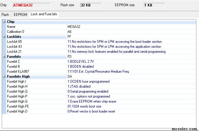

For flashing the MCS Bootloader I did selection as shown in For Bootloader.jpg
The jpg is not consistent, as the value 99 for fuse high does not match fuse-bit high D = 0.
Fuse-bit high D is the BOOTRST fuse-bit.
Means as well you've set BOOTRST, you did not actually program the fuses.
If you would have done so, the fuse high would read 98.
BOOTRST = 0 is correct for jumping to the boot loader after reset.
A fuse bit is programmed if it reads 0.
Do I need different setting for flashing the application program via the bootloader?
With a boot loader used, the controller always jumps to the loader address first.
In case the loader hears its magic word, it invokes loader code, programs the flash, then either hard resets or invokes application code at &h0000.
If not, application code at &h0000 is executed after a timeout.
