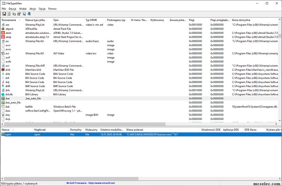

Solution 1.
Problem is that Windows don`t load new instance into "icons you may choose" so for new Bascom instance better is choose "search/explore my computer for open this file" and choose EXE file direct in the folder you explore on your computer.
Open this file with -> Choose another application -> More applications -> at the very bottom of the list -> Search another application on this computer Wink
Solution 2.
On my PC`s I have many Bascom instances installed and when I want to change which one should open my *.bas, *.inc files I`m using this simple free program -> LINK.
I`m using it for years and it work for me on the Win7 and Win10 too. This is the quick way for me Very Happy
Simply find "bas" extention, double click on that showed blue line and change path to the new Bascom instance.
Endy64
Joined: 06 Dec 2006
Posts: 18
Location: Slovenia
PostPosted: Mon Aug 10, 2020 9:34 am    Post subject: Reply with quote
EDC wrote:
Solution 1.
Solution 2.
Thank you a lot, now is fixed and working!

great tool EDC.
Nirsoft has many usable tools.
I added an option to bascom to set the file association for bas,prj and inc files.
