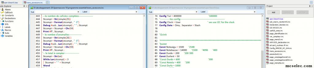

did you try Tile horizontaly in windows option ?
I use it and as Paul said I use projet mode.
my programs are plitted in .inc parts : see in the left cartrige
JP Wink
