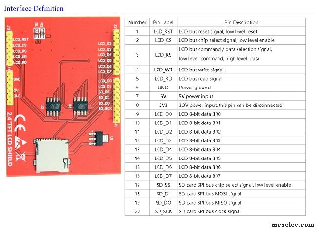

Hi, I buy this module shield: https://www.aliexpress.com/item/LCD-module-TFT-2-4-inch-TFT-LCD-screen-for-Arduino-UNO-R3-Board-and-support/32930176014.html
And this module seems to have connected Touch pins with control&data pins of TFT.
After fast recognition:
- Touch Y-(YD) connected to TFT LCD_CS
- Touch Y+(YU) connected to TFT LCD_D1
- Touch X-(XL) connected to TFT LCD_D0
- Touch X+(XR) connected to TFT LCD_RS
Is possible to use this module witch this library?
It probably makes it impossible to use TFT and Touch in the same time?
I read this post https://www.mcselec.com/index.php//index2.php?option=com_forum&Itemid=59&page=viewtopic&p=68399#68399 and I\'m not first who meet this problem.
Question to Plons...How to declare and chose pins where Touch is connected in version witch shared pins TFT?

@hobby this module looks like it has integrated the level shifters, so should be safe running on 5V.
The reset-pin overlapping with CS is not intended, that's an oversight when translating my xmega environment. However, the reset pin assignment is freely choosable by creating the constant before including the library.
The MIKROE Proto Display is the one I've used developing this driver, so I can confirm it works. The D/C pin is used as clock line in serial modes.
@daro quite certainly there's no problem using the display library itself with shared analog/digital lines, but there is no direct support in the library to also use the touch function in such a configuration.
But maybe you can modify Plons' version (shares WR, D/C, D6 and D7 with touch inputs)? Basically you connect the lines to the ADC pins and alternate their configuration between digital outputs for the display and analog inputs for the touch sensing function.

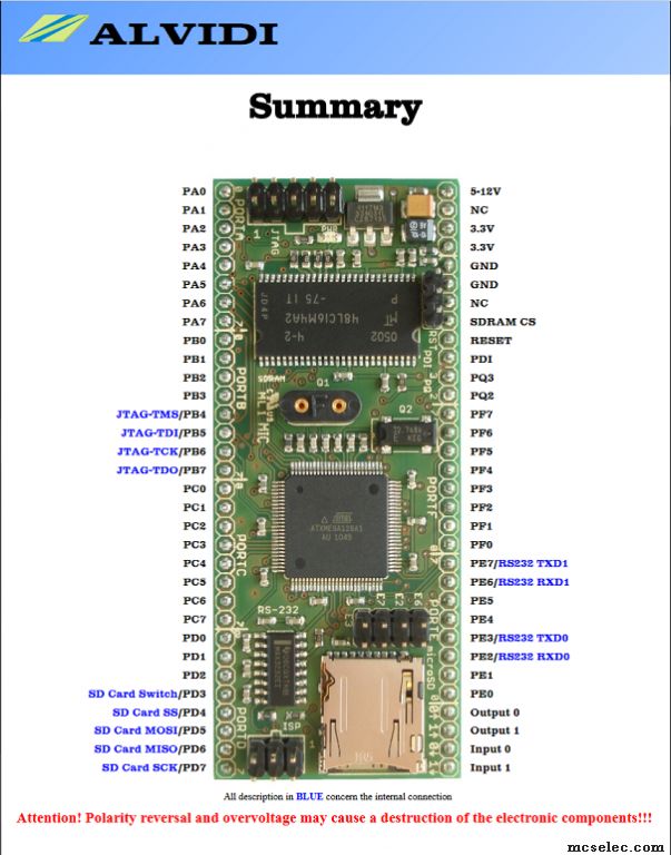

I have a display ILI9341 TFT 2.4" and pcb ATXmega128a1 ( pictures ) .
I tried using the library "ILI9341 TFT Display Driver Library 1.1" https://mat.midlight.eu/index.php?title=ILI9341_Library#Electrical_connection . The video shows that something is wrong https://youtu.be/h82du0wGCR4?si=cdX4lYpYlXzRlqu7 .
I need someone to set up the ILI9341.INC file for me 8-bit parallel port + hardware SPI and described which LCD pins connect to the ATXmega ports.
