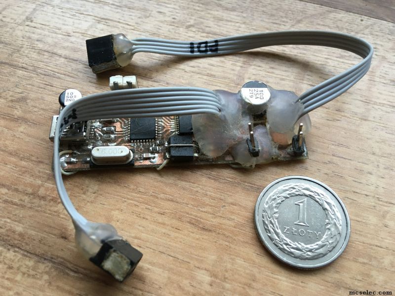

I think Im the hardcore when I watch yours MKII ahahahaha. For what so many parts on them? Maybe they are also debuger?
I build myown MKII years ago. Have spare uC and GTL2003 buffer but this programmer never fail!
Works extremely fast with Bascom and newest Studio 7 with "one click change".
Ive even eatch this PCB Very Happy It use only AT90USB162 and GTL2003. Program is flashed via its own USB and bulit in bootloader FLIP.
Firmware is latest LUFA. PCB and design is not my project but if anyone interrested I can attach whole 1.4MB project with PCB's.
I have newest ICE but this programmer is my favoured one for Xmegas Very Happy

PostPosted: Tue Feb 04, 2020 8:42 pm    Post subject: Reply with quote
this seems to be a variant of the olimex programmer. they have a sch and pcb. the firmware you can also find there.
only the buffer seems different. i must say that GL2003 is a good way. the processor is better protected. but the bat54c will do that nice too so i dont know Very Happy
I can not post the files here but you can download them from olimex site. farnell sells their programmers too so unless you need a lot of them i would simply buy one.
do not forget that these programmers need the avrdude code variant firmware. the firmware is either compatible with studio, or with avrdude/bascom which uses libusb.
but using flip you can simply change firmware.
Or maybe EDC has some other firmware and possible the source.
i do like the EDC slim line version variant :-O
