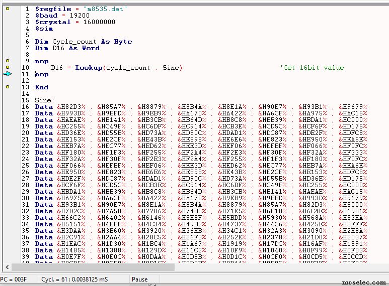

Thanks - tried it, but it seems to only save two cycles 80 -> 78. Maybe I have misunderstood something.....
Cheers
Guy

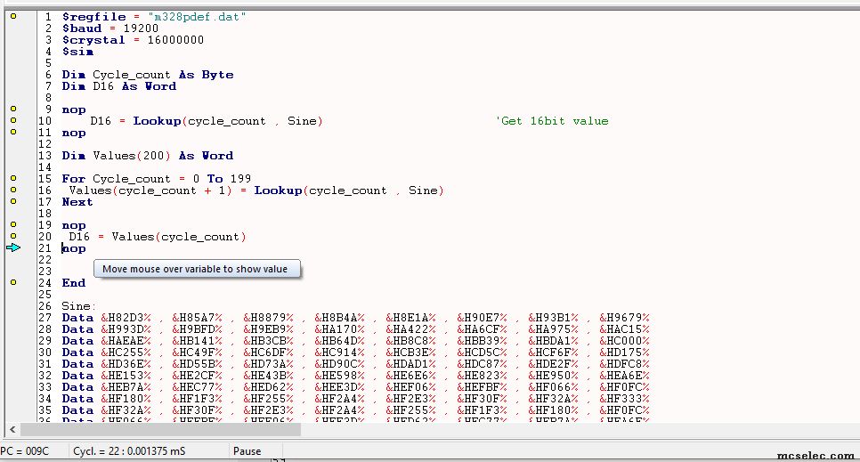

$regfile = "m8535.dat"
$baud = 19200
$crystal = 16000000
Dim Cycle_count As Byte
Dim Dh As Byte
Dim Dl As Byte
Dim D16 As Word
For Cycle_count = 0 To 255
   'First cycle - MAIN Phase (Master/unshifted) to include output etc
   'Get 16 bit sine wave value from table
    D16 = Lookup(cycle_count , Sine)                        'Get 16bit value
   'Get high and low bytes
    Dh = High(D16)
    Dl = Low(D16)
Next
End

This is how it can be measured. Simply insert into your code the "nop" instruction before you want to measure something. Then run Simulator and "Run to this place" then zeros the counter by double click on it. Only then run to the next nop.
I dont think that 61 instructions at 16_000_000 Hz is a critical value here.

0.0038ms I round up into 0.004ms. It means 4us.
If this slows down your code then Im curious how fast is rest of it because it means 250 KHz!

Now we're talking Very Happy
This is how it looks like with SRAM
[/code]
