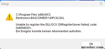

Hello,
I hope, itīs OK to reactivate this old Topic and wish you a Happy New Year 2025.
I found a Problem wit Bascom 8051 Demo Version on the new Win11 24H2.
The installation process seams to be fine but wonder if it is normal that there are no "Additional Files" to be installed.
However, after reboot, the following message appeares (unable to register MFC42.DLL)
The result is that BASCOM8051 stay with frosen startscreen.
Any ideas?
Have also some other problems with the installation of Brother Label Printer Software on Win11 24H2, but this is a different story.
Best Regards RePi
Posts: 6198
PostPosted: Wed Jan 08, 2025 3:34 pm    Post subject: Reply with quote
I am in the process of installing a new win11 PC to replace my old dev pc.
First advise : install with a local account. (google for details). Or use MS account and add a local admin account later.
bascom should be installed with local admin rights too.
when you use a demo (might be time to get a license?) there are no additional files. The license is missing for example.
The error you get is because some system components can not be registered. Do not know why some have that problem and other do not.
See here : https://www.mcselec.com/support-center/index.php?x=&mod_id=2&id=56
How to fix it.
A future version will not use these components anymore
plouf
Joined: 19 Jan 2012
Posts: 102
Location: Athens,Greece
PostPosted: Wed Jan 08, 2025 6:08 pm    Post subject: Reply with quote
I had similar issue but it was delayd for several aeconds/minites then it started
Have tou try bascom avr ? Does the same?
Christos

PostPosted: Thu Jan 23, 2025 5:19 pm    Post subject: Reply with quote
Thanks for reply.
Bascom AVR installation works fine so far.
Local admin rights are present. I will check for local account tomorrow.
Thanks
plouf
Joined: 19 Jan 2012
Posts: 102
PostPosted: Thu Jan 23, 2025 5:22 pm    Post subject: Reply with quote
i had the same exact problem but with delay like a few minutes, with DEMO
when i get FUll version which a newer version (2.0.18.0) work instant
so as long as bascom-avr start fast is the same issue of the "old" ide Smile
