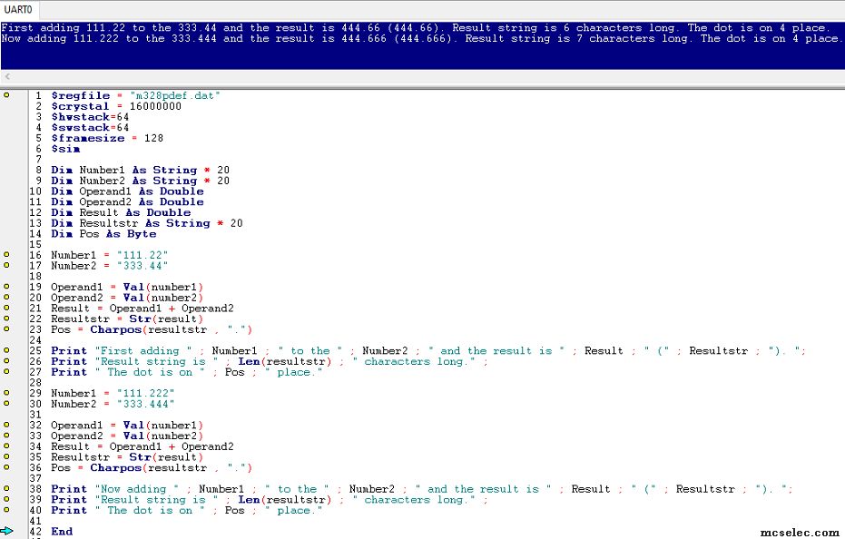

i making 7 digit LED calculator, and have problem with result, after operation on single and double operation.
I input data from keyboard switches into string:
Code: | Dim Number1 As String * 8
Dim Num As String * 10
Number1 = Number1 + Num 'Num is select by switches. |
Same for next operand (Number 2)..As Num you can type dot "." into string to type single number.
Next convert:
Code: | Dim Operand1 As Double
Dim Operand2 As Double
Dim Result As Double
Operand1 = Val(number1)
Operand2 = Val(number2)
Result = Operand1 + Operand2 |
Now we never know what result is, so never know how long fraction of a Double is.
I trying to INT, and FRAC function but it seems to not work with Double? Single is not enough accurate for me.
Other method is:
Code: | Num = Str(result)
Pos = Charpos(num , ".") 'calc dot position on LED display
Pos = Pos - 1
Dot(pos) = 1
Delchars Num , "."
For I = 1 To 7
Str_array(i) = Mid(num , I , 1)
Dig(i) = Val(str_array(i))
Next |
but this result tralling zeros after number (after fraction part).
And is problem with dot position. For example:
111.222+333.444=444.666, and dot position from Pos = Charpos(num , ".") is correct, but 1111.222+3333.444=4444.666, and position is calculated wrong, becouse for example 4444.666 schould be Pos=5, but is 2...why?
For example 111.22 + 333.44, result display: 444.6600 (last two zeros are not needed), schould display _ _ 444.66. _ _ is leading off digits...
What is better way to convert result from a single/double, to array of digit for 7 digit LED display? (without tralling zeros after fraction part)
(BASCOM-AVR version : 2.0.8.2 , Latest : 2.0.8.4 )
EDIT. It seems them Charpos function (Pos = Charpos(num , Search_str)) not work propertly with Double data. When I change Result fot Single, Pos is calculated corectly.
So how to convert Double result in string, or 7 byte array, and read coma position? |

Daro,
Show us your complete code that's not working.
Code from EDC is working, so maybe you do something else wrong.
Low stack? _________________ www.evertdekker.com Bascom code vault |
