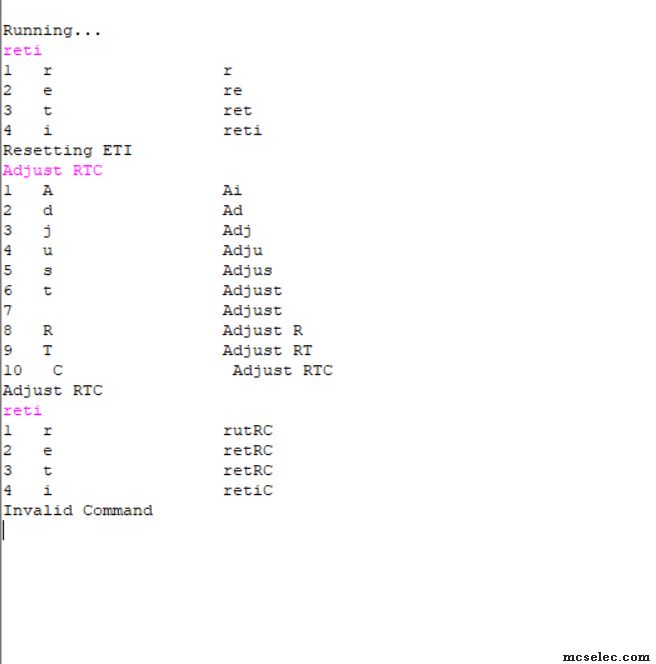

I am having an issue with using Delchar to clear the contents of a string that is built from characters received through USART0. I've been fighting this for a while and thought I would ask if there is something that I am missing.
I've included my whittled down code and a screen shot of the output to the computer. I've added some print statements to show what is going on.
Here's what is happening:
When the code is run for the first time, everything works and looks right on the screen. The string is built as it should be with each character received. When the full message has been received and acknowledged, the delchar statement is used to clear any of remaining string contents from memory to prepare for the next message arrival.
However, after more messages are sent, it seems as if all of the characters have not been cleared from the string. Looks as if every other character is cleared and the rest remain. Eventually, enough of the wrong chars are present that a valid message is considered invalid because of lingering chars.
If I insert a print statement (which I did remove, sorry) after the delchar statements it will show an empty string. But somehow when the next message arrives there are some "old" characters mixed in with the new as shown in the screen grab.
Here's a screen grab of what I'm seeing
[/img]

PostPosted: Fri Jul 02, 2021 1:00 am    Post subject: Reply with quote
When you build a string by inserting characters with the mid statement, the next character will be whatever is left over from when the string was last used. But bascom assumes that the end of the string is where the next null character is. One way to fix this is to insert a null one character count beyond where you are now. That way the current string always ends with a null, and does not 'run over' into old remmnants.

PostPosted: Fri Jul 02, 2021 3:42 pm    Post subject: Re: Problem with Delchar Reply with quote
sshorter wrote:
      delchar eval_string_0, 1
      delchar eval_string_0, 2
      delchar eval_string_0, 15
I'd say if your intention is to write maximal inefficient code, you're on your way.
To solve the puzzle about delchar: it does not do what you expect.
Removing the 1st char, 2nd char becomes 1st char.
Removing 2nd char, 3rd char becomes 2nd char.
After removing the 8th char, the string-end moved thus far to the front, that the remaining delchar's actually do not have any effect.
If you want to keep your code, simply replace the whole delchar block against:
Memfill eval_string_0, 15 , 0
Not tested, but should work ok.

PostPosted: Fri Jul 02, 2021 4:42 pm    Post subject: Reply with quote
I know the code was inefficient in the operations. There was a better way...just trying to easily show what I was trying to do.
That being said, thanks for letting me know that the chars were "shifted" when using delchar. That explains everything.
I'll make some changes and give it a shot.
