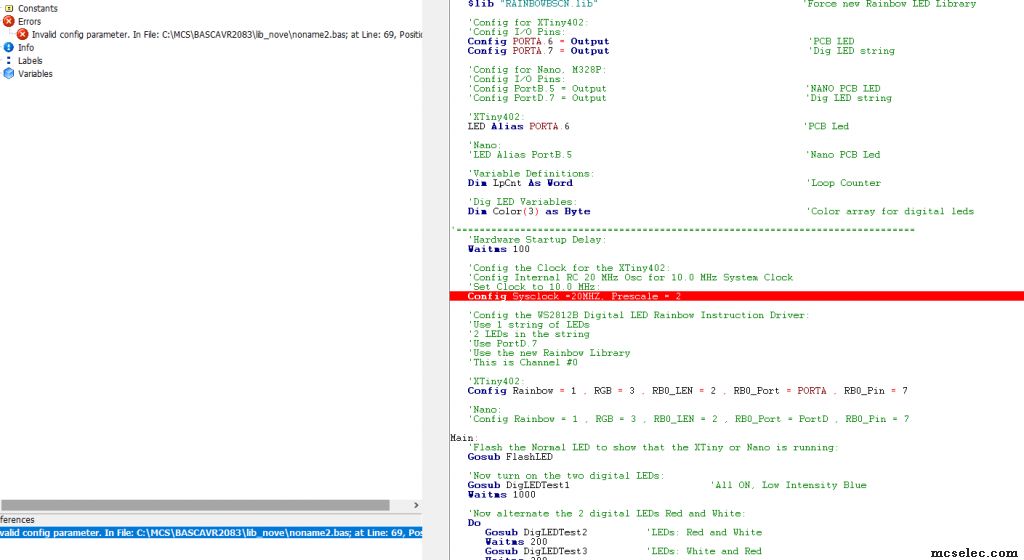

I don't know how to do you
Config Sysclock = 20MHZ, Prescale = 2
warns me of an error.
Should be
Config Sysclock = 16_20MHZ, Prescale = 2
It compiles ok on 2.0.8.3
What exactly does it tell?

About the sysclock option : it was 20MHZ first.
But that did not reflect properly that this osc can be changed between 16 and 20 with a fuse.
So it has been renamed into : 16_20MHZ
