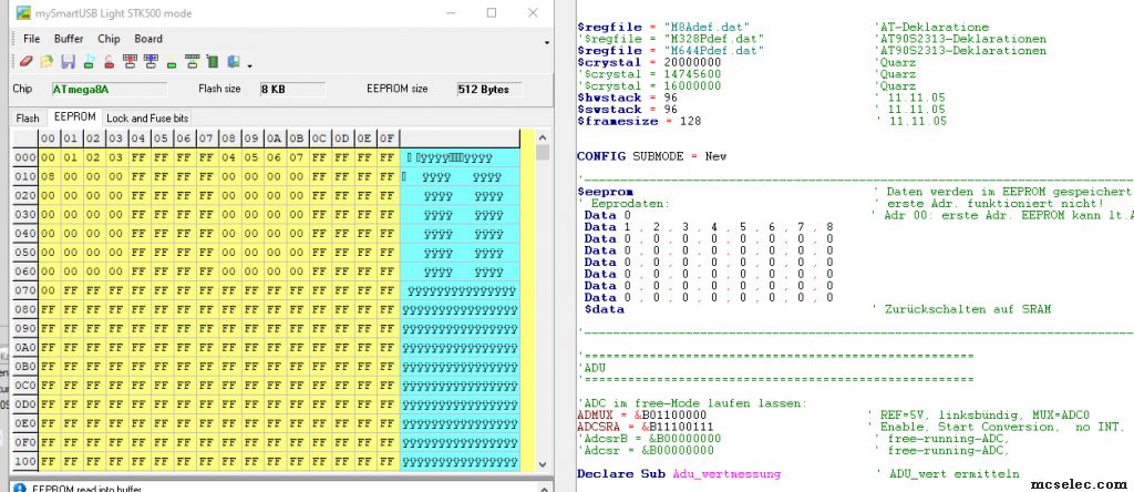

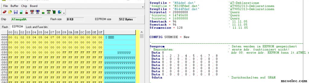

Posted: Sun Oct 04, 2020 2:24 pm Post subject: BASCOM 2083 EEPROM Programming fails |
Hello,
here is the excerpt of the result after the
EPROM programming from BASCOm 2083:
and here is the excerpt of the result after the
EPROM programming from BASCOm 2082:
the difference is clearly visible.
