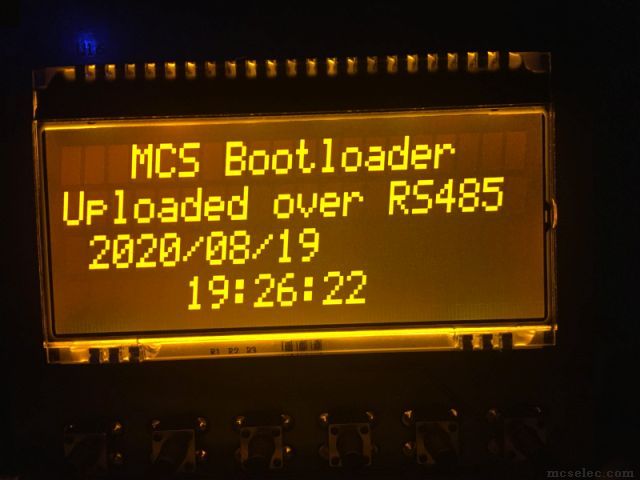

PostPosted: Wed Aug 19, 2020 6:40 pm    Post subject: Reply with quote
I test it today on 2083. Works like it should even over RS485.

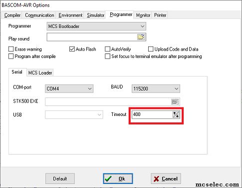

PostPosted: Thu Aug 20, 2020 7:38 am    Post subject: Reply with quote
Baudrate is not the problem. Im flashing via HC-05 with Baudrate 115200 @16MHz.
Better set longer Timeout for opening port (see pic) or check service settings if your Bluetooth for PC is a USB dongle.

PostPosted: Thu Aug 20, 2020 8:09 am    Post subject: Reply with quote
ok, thx
I will change the Port Timeout today.
It is a USB-dongle... what kind of Settings do you mean?
thx
