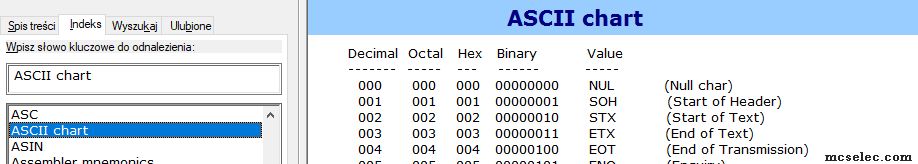

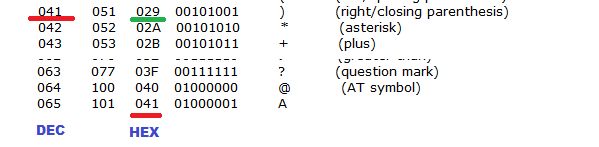

Better hit F1 in the Bascom and type "ASCII chart".
Then you realize that 41 in decimal means ")" and capital "A" uses 65 Wink
