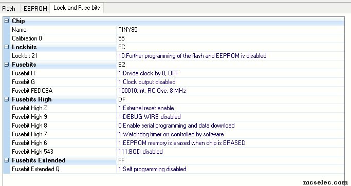

Posts: 1197
PostPosted: Tue Jun 30, 2020 3:04 pm    Post subject: Reply with quote
I managed to set the clock to 8MHz but maximum arrival at 35KHz ...
for a T85 I use
programmed with Mysmart USB lignt ISP program
to do that : add this line after the end
$prog &HFC , &HE2 , &HDF , &HFF ' generated. Take care that the chip supports all fuse bytes.
for the pwm, I think you must search in the forum
but the pin for pwm is not the reset one Wink
You have fast pwm possibilities with Tiny : see the datasheet
timer are only 8bits
JP
