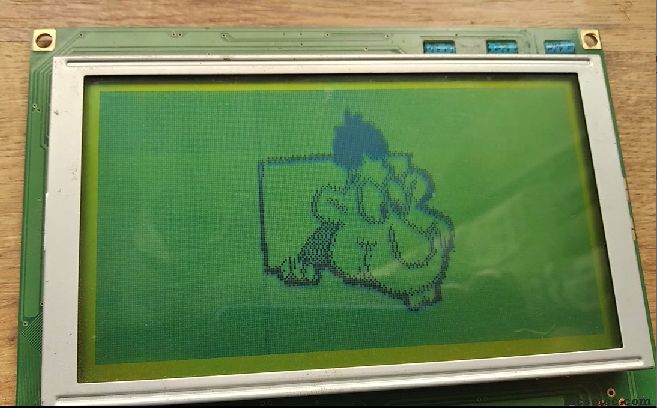

@mfulde I cant confirm that problem. Everything works perfectly fine.
Years ago I made strip cables for quick attach and connect this display into some dev. boards so today it was a minute.
..and look what I compile today with Bascom 2082 Very Happy An animation on this display based on the BGF (I export some frames from animated GIF and convert them)
At the end of animation the text in polish language means "You have mess on your desk" Very Happy
(live looks better, camera cant show it)

If you want I can try display your BGF if you attach it or compile some HEX but for this config will be prefferable.
Config Graphlcd = 240x128 , Dataport = Porta , Controlport = Portc , Ce = 4 , Cd = 7 , Wr = 5 , Rd = 6 , Reset = 3 , Fs = 2 , Mode = 8
'mode 8 gives 240 / 8 = 30 columns , mode=6 gives 240 / 6 = 40 columns
Cursor Off
Cls
PostPosted: Thu Jun 04, 2020 12:02 pm    Post subject: Reply with quote
when you create the bgf you can select the font. 6x8 or 8x8
this should match the setting of the config
mfulde
Joined: 24 Apr 2007
Posts: 21
Location: Lonsee, Germany
PostPosted: Thu Jun 04, 2020 7:08 pm    Post subject: Reply with quote
Hei Mark,
THAT's IT Smile
Completely my fault ..... yes ... the problem was sitting in front of the Keyboard !
What ever I tried out in the last days, I did / had a not matching configuration ... mode 6 and mode 8, 6x8 and 8x8 ....
NOW, Mode is 6 and BMP was regenerated with 6x8 and .... wonder by wonder ....
ITs WORKING FINE!
Thanks for your help and the relevant hint.
Regards,
Markus
MaFu
PostPosted: Fri Jun 05, 2020 9:45 am    Post subject: Reply with quote
ok, glad it is solved. i added this info to the help since it was missing.
