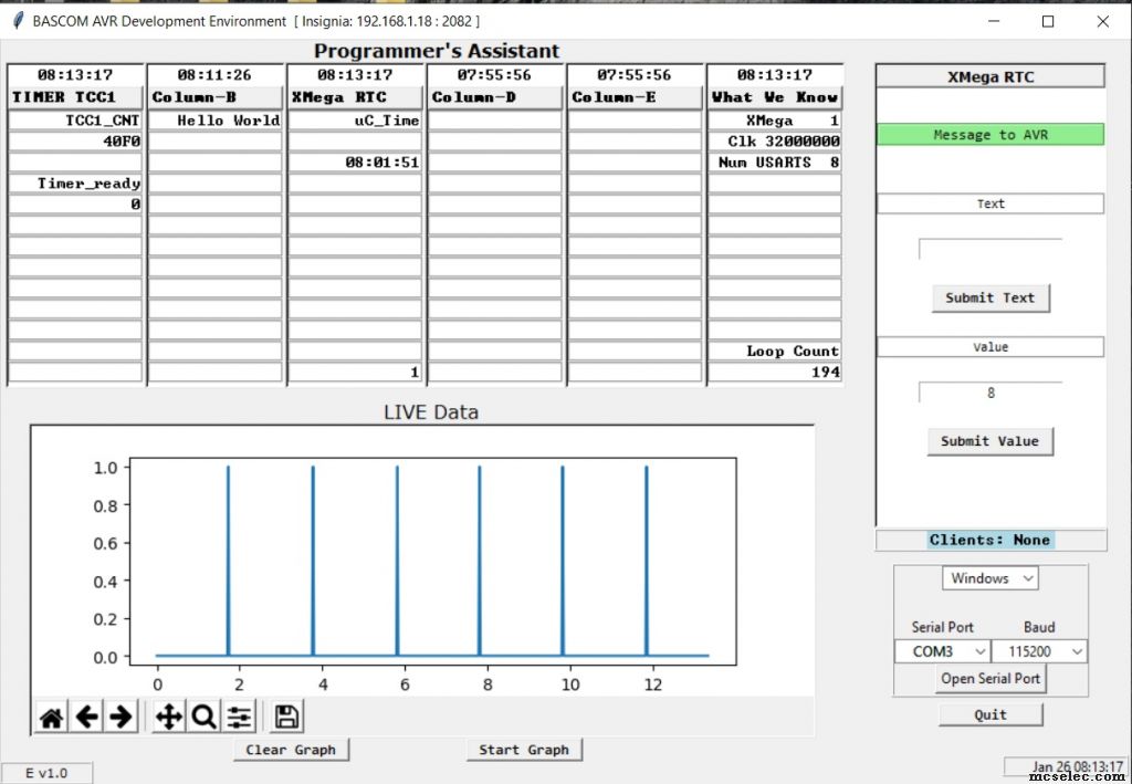

Hello,
During code development and troubleshooting, many programmers/developers send UART messages to a Terminal Program. As an alternative, I developed the AVR Programmer's Assistant.
It uses the same logic as an Excel Spreadsheet with addressable Columns and Rows. It also provides a Real-Time graph for streaming Live Data.
The AVR Programmer's Assistant is written in Python and the BASCOM Code is shown below:

The installation and operating instructions are included in the attached *.ZIP file.
Please provide feedback and improvements.

hi Enniom,
thank you for taking the time to share.
it is very good documented. nice that you can have access from multiple pc's.
while the sample is for XMega it will work for other AVR as well Very Happy
