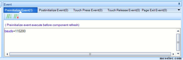

The nextion display is set to 9600 baud at the start.
You have to write code in the nextion editor to change from this.
Regards Paul

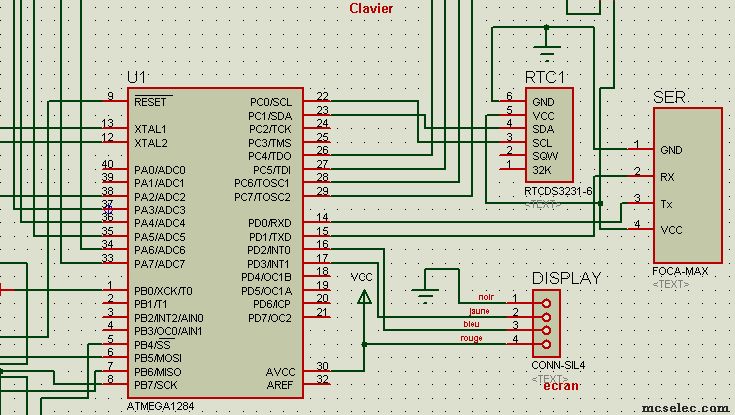

sorry, but i am very frustrated. in your powerpoint first stap is blue/yellow connected on rx0/tx0..on your bascom example is it tx1/rx1....
how baud-rate is right? how can i find the right baud rate for bascom..
Yes it is right , on the last exemple I use another couple of port because I use 2 serial port
1 for Debug tx0/ rx0 com1
1 for nextion tx1/rx1 com2
on the power-point Idid'nt use debug
Now I use my own card , not a arduino , but It is approx the same wiring

'M1284------------------------------------
 ' RXD1= yellow to  PD3
' TXD1= Blue to  PD2

As Paul said you must add bauds=xxxx the speed you choice in the Nextion
then debug and save in the *.tft file

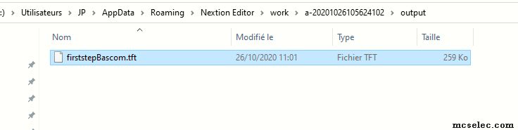

This file must be copy to a mini-sd card and charge it in the display
