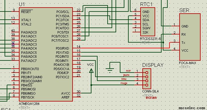

Posts: 1197
PostPosted: Sun Oct 04, 2020 7:16 pm    Post subject: Reply with quote
here my M1284P
I use the focamax from nextion as regulator for Pw supply and I use it too for second serial com port to debug my program
PD2 and PD3 are second serial port
'* CONFIG BUFFERED USART FOR USB *
Config Com1 = 115200 , Synchrone = 0 , Parity = None , Stopbits = 1 , Databits = 8 , Clockpol = 0
Echo Off
Config Serialin0 = Buffered , Size = 30 'RX from Terminal
Open "COM1:" For Binary As #1
Const Usb = 1
'M2560-------------------------------------
' RXD0= yellow to PE0 tx0
' TXD0= Blue to PE1 rx0
'M1284------------------------------------
' RXD0= yellow to PD0
' TXD0=yellow to PD1
'---serial port-------------------------------------------------------------------------------------------------------------
Const Nex = 2
'Config Com2 = 19200 , Synchrone = 0 , Parity = None , Stopbits = 1 , Databits = 8 , Clockpol = 0 '34800 modif le 12-02-2020
Config Com2 = 115200 , Synchrone = 0 , Parity = None , Stopbits = 1 , Databits = 8 , Clockpol = 0 '19200 modif pour ecran intelligent
Open "COM2:" For Binary As #2
Config Serialin1 = Buffered , Size = 50
Config Serialout1 = Buffered , Size = 30
jp Wink

you use com2
Pin D2/D3
i have Com1, Pin D0/D1. if i change it in
Config Com1 = 115200 , Synchrone = 0 , Parity = None , Stopbits = 1 , Databits = 8 , Clockpol = 0 '19200 modif pour ecran intelligent
i got error : external routine not found in nextion.inc
For Binary As #2 send no error...but #2 is com2,or?
Thank you
