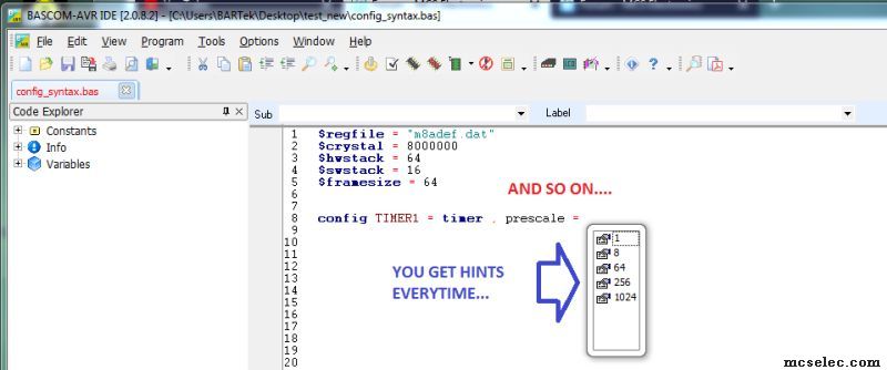

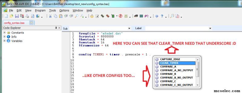

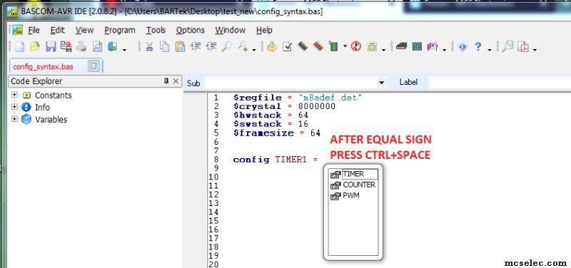

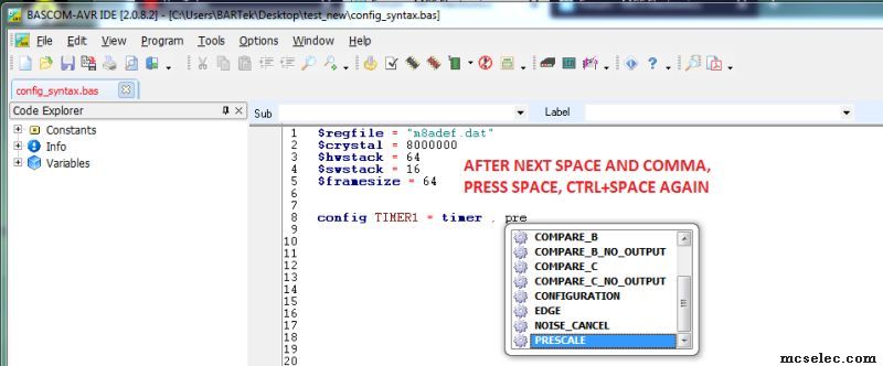

Try use CTRL+SPACE for proper syntax. After some word make space, eual sign =, next space and then call for hint CTRL+SPACE
