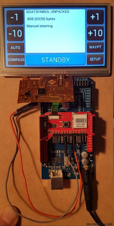

I am not sure how many of you have used the FT80x in a design, but have a look at some if the examples on You-tube and you will hopefully be impressed.
I have used it for an autopilot front end which behaves well and cold be illustrative. I can make a short video of it if you like. I can also contribute withthe code to show how Butonns, fonts, menus, text, sliders and touch works in a real application.

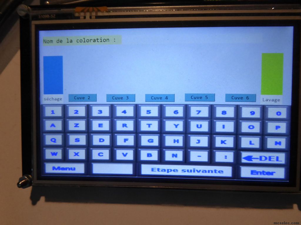

for my part I bought a FT8x compatible display that is still in its packaging because of no example of use. (from [url]https://www.hotmcu.com/5-graphical-lcd-capacitive-touch-screen-800x480-spi-ft811-p-301.html?cPath=6_16&zenid=8qdm0vfrip5th431irsuefm655)[/url] I can't start it Crying or Very sad
On the other hand I use Nextion HMI display
At the request of one of my friends I am currently creating the control interface of a lab device with a lot of parameter requests. We choose a Basic 5"
I have simplified as much as possible the tasks offered by nextion
for example I no longer use buttons but text boxes and the hot spot area on image.
the gauges are very useful and very simple etc...
The development time is divided by 5 and an Atmega 1284 is more than enough. The speed is breathtaking.
The "touch-control" is resistive but reactive enough for what we have to do with it
it also exists in capacitive for the 7".
As for the price, it is reasonable.

If you like Visual Basic you will probably also like the way FT8xx works.
To give you a view of how an FT800-display with Resistive touch is handled as a frontend to a Shops autopilot I have made a small Video on YouTube.
https://www.youtube.com/watch?v=F-Mf9tM7jxo&t=58s
No external Flaschcard or RAM is used. All data comes from the AVR2560. The boat-symbol is a bitmap consisting of one half where a mirrored clone is used to save space in the AVR.
You can see that if you look carefully. The two halves sometimes doesn't move absolutely synchronous Smile
I will post the Bascom code as soon as I have cleaned it up a litte so you don't get pissed off... Wink
My hope is that you buy one of these displays and run the code while checking it up.
Observe also that, like Mark mentioned, there are lots of examples in the Bascom Sample area. Thy them!!
I attach a picture of the hardware setup. A standard Arduino mega 2560. A shield for fitting the display strip and the Display with FT800 on a flexboard.
/Per
