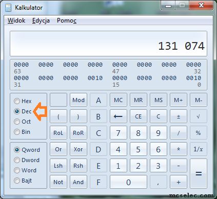

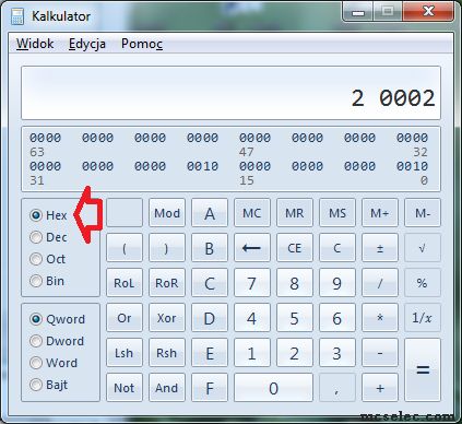

Posts: 1136
PostPosted: Sun Nov 03, 2019 10:13 am    Post subject: Reply with quote
I dont know if I understand your question but value you present is quite expected Very Happy
Value 65537 DEC is 00_01_00_01 HEX. Two times for our Myx=1 and Myy=1. Value of Mytype dont mather cause we watch for two bytes in our order.
I dont know how Bascom handles those adressess for Me but it does Very Happy and I know I can do this that way.
I can gues that for Myx=2 and Myy=2 value of Mytype will be 131 074 Very Happy
