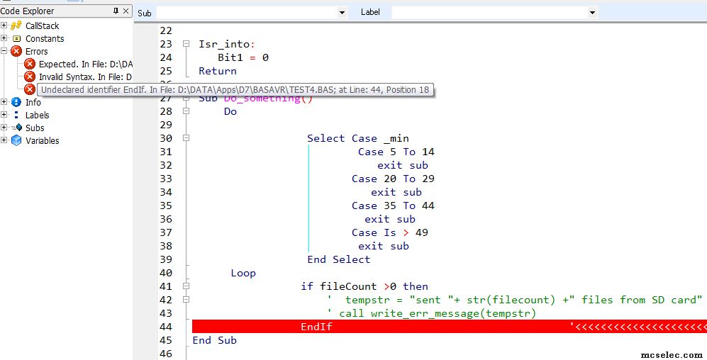

PostPosted: Thu Oct 10, 2019 8:40 am    Post subject: Reply with quote
maybe you think the forum rules do not apply for you?
when posting code, it must be complete, not some fragment that needs work.
when posting, it should be clear what it is you want. is this a question? or you want to share your project? or you reply to someone with help?
And more important, consider who can answer. is it a forum cry for help or should you write to mcs support?
in your case it seems like a question to get an error?
well it is actually there when you check the Code Explorer
Why not at compile time? Well it was there some versions ago but lot of users like to use endif instead of end if. So the compiler accepts it. Like always, you can not make everybody happy.
The IDE can reformat your code when you type endif it will change into End If.
