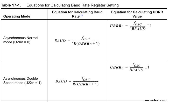

Baudrate is determined by UBRR register and U2X (double speed) bit.
Values for BAUD (UBRR) are precalculated by compiler but this is easy task to do it by micro.
You simply open the datasheet of your Mega1284 and find the formula...

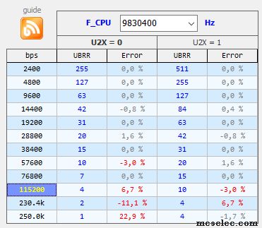

So this is simple to write your own Sub or Function to do so but because of your weird crystal you should stick to U2X = 1 because of large error that should not exeed 2%.
Look how calculated UBRR and Error looks like for your clock :
So for calculating any BAUD you simply do math (9830400 / 8 / Desired BAUD) - 1 and thats it.
UBRR = ((9830400 / 8 / 9600) - 1) = 127 (compare it with calculator Very Happy )

Thanks guys for the comments. I found that U2X needed to be set because of the high err at 115200 and my Xtal freq. I decided to run thru the loop again so that we ended up with U2X=0 for the higher USART sample rate. Not sure if this has any advantage but it seems like a good idea.

As general rule U2X = 1 gives the same or better error, compare to the baud rate example tables from the data sheet, USART section.
By comparing U2X = 0 vs. U2X = 1 over the shown clock frequencies you'll notice that if an error of 0% appears at U2X = 0, there is always 0% at U2X = 1.
Where the error is > 0% at U2X = 0, then the U2X = 1 error is always same or better.
This is simply explained by 'finer' sample steps.
Keeping U2X always on seems to be a sound idea.
The limit is not the higher baud rates, in contrary, only with U2X = 1 the highest baud rates can be achieved.
The limits are super slow baud rates at high clock frequencies, because of the 12bit-wide UBRR.
At 20 MHz clock, U2X = 1 and UBRR = 4095 the baud rate calculates to 610 baud, the half at U2X = 0.
It is senseless, as you have the same error of 0% at the lower baud rates, regardless of U2X = 0/1, while the error at the two higher baud rates is much more acceptable with U2X = 1 (1.6/-3,0%), than double as high error with U2X = 0.
The only reason running tests with off-center baud rate is in case the connected hardware is off-center too.

That all makes sense, and the error at my chosen 38400 baud rate is the same for both cases. I was thinking more of receiver performance & the lower sampling rate with U2X =1, where the sampling rate is 8x instead of 16x. Because the receiver decision ss to whether a bit is an 0 or a 1 is based on a majority decision of the samples - its seems logical that 16 samples should give a better result ?
You misunderstand. Read U2X as U(art) 2(double) X(speed), from the data sheet "Double Speed Operation (U2Xn)", if set to 1 the option is on, otherwise off.
Definitely not, the prescaler for the sampling rate is 8 instead of 16, which means the sample rate is higher.
Easy to see from the data sheet's baud rate equations, at U2X = 1 one divisor becomes 8, if the dividend (fOsc) stays the same, then the quotient (baud) gets higher.
As written, you confuse sample rate with sample rate prescaler.
