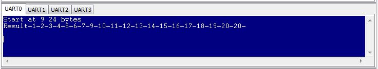

Maybe like that Very Happy
$regfile = "m2560def.dat"
$crystal = 20000000
$hwstack = 100
$swstack = 100
$framesize = 100
$sim
Config Submode = New
Dim N As Byte , Helpb As Byte
Dim Spoint As Byte , Bytes As Byte
Dim Table(20) As Word
Sub Remove()
 Spoint = N + 1
 If Spoint <= 20 Then
    Bytes = 20 - N
    Shift Bytes , Left , 1                                  'multiply bytes by 2 for WORDs
    Print "Start at " ; Spoint ; " " ; Bytes ; " bytes"
    Helpb = Memcopy(table(spoint) , Table(n) , Bytes)
 Else
  'handle end of the Table(20)
 End If
End Sub
'fill table
For N = 1 To 20
 Table(n) = N
Next
'check for "8"
For N = 1 To 20
 If Table(n) = 8 Then Call Remove()
Next
Print "Result ";
For N = 1 To 20
 Print Table(n) ; "-";
Next
Print
End

PostPosted: Wed Mar 27, 2019 3:51 am    Post subject: Reply with quote
Thank you very much EDC, it works perfectly.
But you can tell me what I did wrong with my code, I used Memcopy on other occasions and I have not had any problems.
Best regards.
Posts: 1136
PostPosted: Wed Mar 27, 2019 7:37 am    Post subject: Reply with quote
Bytes = Memcopy(origen , Destino , Cantidad)
This code not work like you suppose. Variables Origen and Destino contain address of the other variable but this no mather and Memcopy takes their addresses (adresses of the Origen and Destino).
