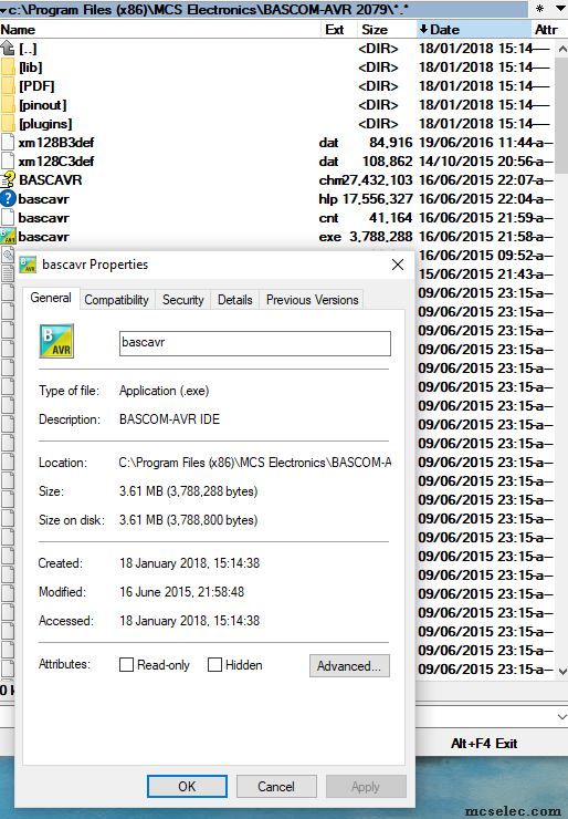

PostPosted: Thu Sep 13, 2018 8:36 pm    Post subject: Reply with quote
Almost the same, not that huge difference that you have.
I suggest that you upload the bascavr.exe 2079 version to https://www.virustotal.com to check it.
No virus detected.
Very strange. Are you shure about your versions?
No question, my version 2079 shows up in explorer as 2079...
See attachment please.
Evert :-)
Joined: 18 Feb 2005
Posts: 2165
PostPosted: Thu Sep 13, 2018 9:05 pm    Post subject: Reply with quote
Yep, I'm really sure.
We are talking about the bascavr.exe 2078= 3.7Mb, 2077= 5,4Mb, 2076= 3,5Mb
So following this line your file is way to big.
Did you renamed it or has it for other reason a different name then bascavr.exe ?
