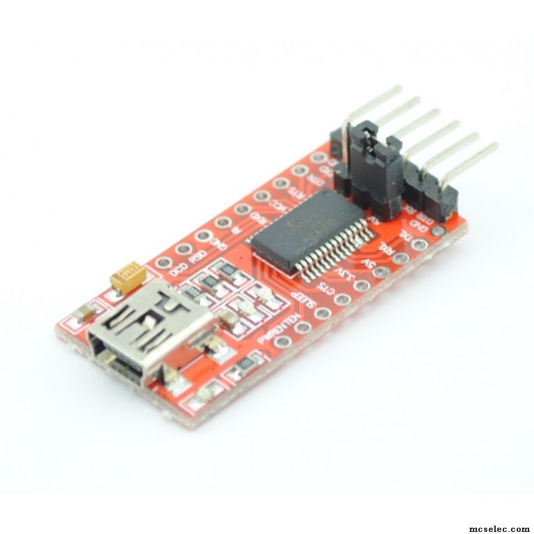

I anticipated that and already got a FTDI FT232RL board. See picture. This is a very adaptable board.
It is the same solution as Meister suggests.
