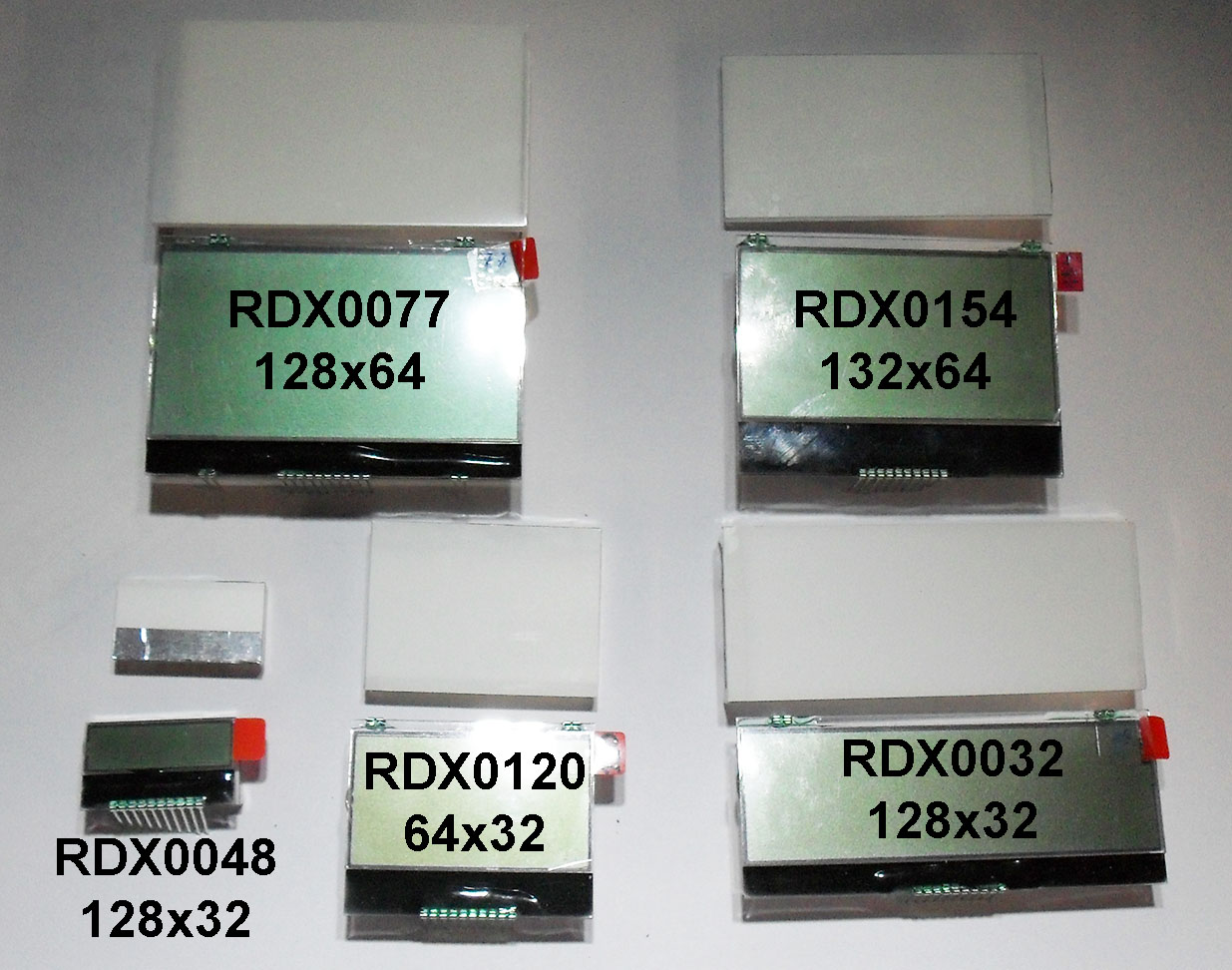

Ukraine firm "Gamma" produces COG B&W graphical display:
RDX0032GC - 128x32
RDX0048GC - 128x32
RDX0077GC - 128x64
RDX0120GC - 64x32
RDX0154GC - 132x64

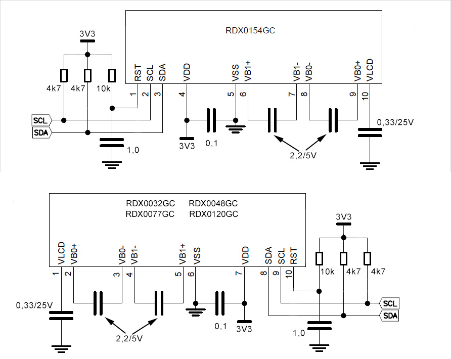

And backlight for him. LCDs based on chip UC1601S and has 3,3V I2C interface.

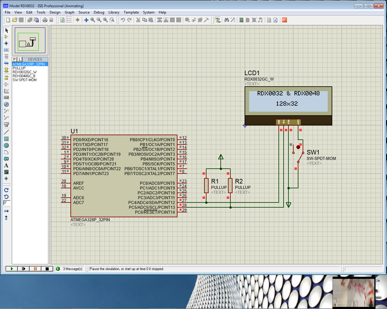

Library support Text, Pixel, Line, Circle, Box, FillBox, Picture and Contrast commands. Tested on 2.0.7.1. & 2.0.7.7 versions.
Models for Proteus written by MONIKYS (Ukraine). Tested on 7.10 & 8.1 versions.
Test examples included.
