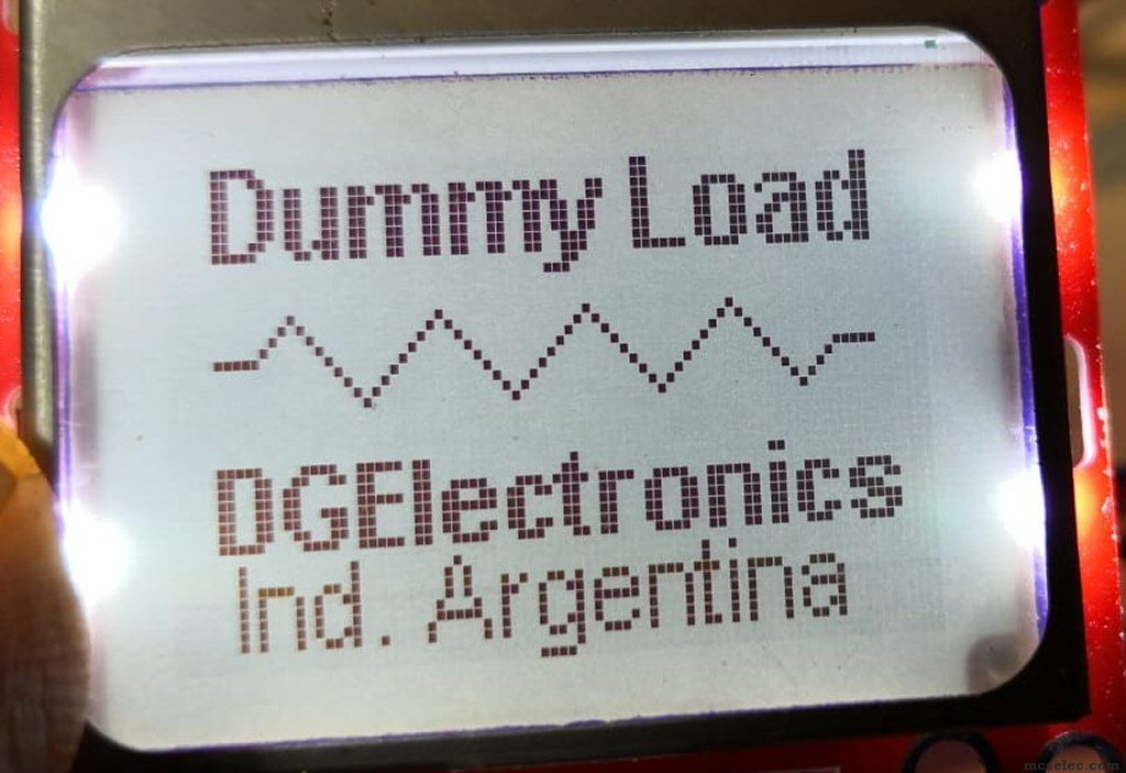

Hello everyone, I am using the lib for the nokia 3310 and I have a problem with the contrast, I have tried with lcdcontras = x (0 to 127), also with Glcdcmd 33: Glcdcmd x, before and after the initlcd but although in some Opportunity worked, then I stopped. I send a photo to see if someone with more experience in this display can guide me.
Thank you very much and best regards.

PostPosted: Thu Sep 26, 2019 3:11 pm    Post subject: Reply with quote
Hi O-FAMILY, thank you very much for your quick response. Change the lib and delete the cls but everything remains the same.
$lib "glcd-Nokia3310_V2.lib"
Config Graphlcd = 128x64sed , Rst = Portb.2 , A0 = Portb.4 , Si = Portb.3 , Sclk = Portb.5
Const Negative_lcd = 0                                      'Inverting screen
Const Rotate_lcd = 1                                        'Rotate screen to 180°
'I have tried these alternatives with values from 0 to 128 (255) but nothing changes, I am certainly doing something wrong
'Glcdcmd 33 : Glcdcmd 0
lcdcontrast=0
Initlcd
'Cls
lcdcontrast=0

PostPosted: Fri Sep 27, 2019 6:05 pm    Post subject: Reply with quote
I found the problem, the defect only does it when the screen rotates 180 degrees

You can usually change the contrast, but do you mean that the contrast does not change when you rotate the screen 180 degrees?
sielcon
Joined: 16 Mar 2006
Posts: 82
Location: Argentina
PostPosted: Mon Sep 30, 2019 1:08 am    Post subject: Reply with quote
Sorry O-Family, the subject is like this, as you said the red board displays do not change the contrast and mine is not the exception, what I found is that the problem that is seen in the photo is that only rows 8 and 44 look with good contrast, the extra ones look very dim, in this case I had the screen rotated 180 degrees (Const Rotate_lcd = 1), but this problem disappears when the screen is set in normal mode (Const Rotate_lcd = 0) . Sorry again for expressing myself incorrectly.
Thank you very much for your time.
Best regards.
O-Family
Joined: 23 May 2010
Posts: 338
Location: Japan
PostPosted: Mon Sep 30, 2019 1:58 am    Post subject: Reply with quote
Hi,
understood.
Your problem is the dark line in your first photo.
The two types of LCD I have do not cause such symptoms even when the screen is flipped.
Therefore, I don't think the settings for the software and LCD are strange.
Also, if normal contrast is obtained when the screen is reversed, I don't think the LCD bias setting is strange.
Try various numbers and positions of characters to display.
Since this LCD is a second-hand product that has been removed from a Nokia second-hand mobile phone, there is no guarantee of normal operation.
Furthermore, since the controller and specifications used for each lot are not fixed, analysis is difficult.
Since it is an inexpensive LCD, try several other types.
