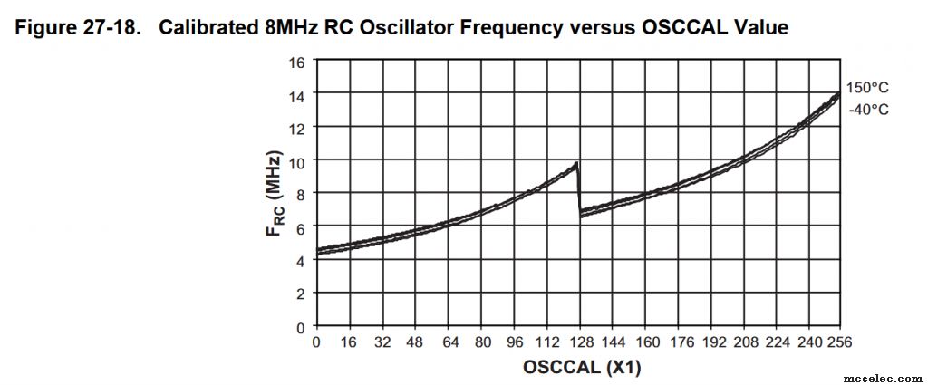

If we look into datasheet OSCCAL near value 128 is the most stable in terms of temperature. When you're saving to register 170 value you may have clock even little below 8 MHz.
Looks like you do not understand the concept of OSCCAL.
Firstly, if it would be that easy as the shown 27-18 diagram suggests, then OSCCAL would make little sense, simply have it set to 128 and get a reasonably stable 8MHz out of the RC under all conditions.
Alas the frequency of the RC is voltage-, temperature- and, tadaa: production-dependent.
Because of this it's written that:
During reset, hardware loads the calibration byte into the OSCCAL register and thereby automatically calibrates the RC oscillator.
The calibration byte is created and written at production time into the controller at 25°C / VCC 3V.
This procedure already suggests that the calibration byte's value may be anything else than 128.
Your argument of 'most stable' at value of 128 is therefore moot, as it won't help to search within the bright areas, if you've lost something in the dark ones.
By measuring temperature, controller's supply voltage and running an OSCCAL calibration procedure before doing any serial transmission, the RC can be reliably used for serial communication or any other reqeuirement for a reasonably exact clock under non-lab conditions.

If you set OSCCAL generally to "128" and there is a change in temperature, you might
have a frequency jump of around 1.5 MHz total (up-down). Take a closer look at the chart. There are two curves , one lower and one upper. The upper starts at a much lower frequency than the end of the lower curve.
Setting OSCCAL to 128 is in my opinion not a good thing to do. The Manufacturer does not really tell anything to my knowledge about this???
Regards Hubert

You have right regarding OSCCAL=128.
I had 10 or 13 devices where changing register between 126-129 provided nice stability. Probably I had "golden samples" Very Happy
