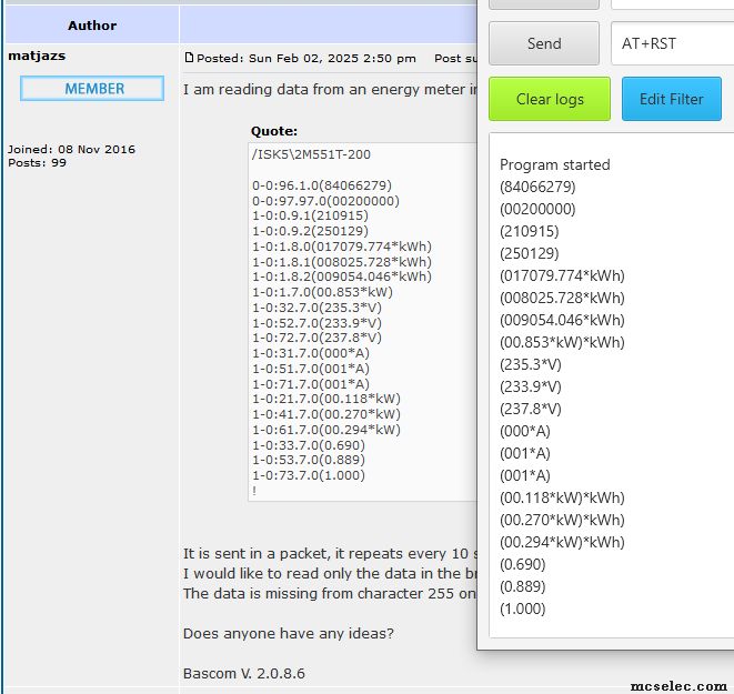

I am reading data from an energy meter in this format:
/ISK5\2M551T-200
0-0:96.1.0(84066279)
0-0:97.97.0(00200000)
1-0:0.9.1(210915)
1-0:0.9.2(250129)
1-0:1.8.0(017079.774*kWh)
1-0:1.8.1(008025.728*kWh)
1-0:1.8.2(009054.046*kWh)
1-0:1.7.0(00.853*kW)
1-0:32.7.0(235.3*V)
1-0:52.7.0(233.9*V)
1-0:72.7.0(237.8*V)
1-0:31.7.0(000*A)
1-0:51.7.0(001*A)
1-0:71.7.0(001*A)
1-0:21.7.0(00.118*kW)
1-0:41.7.0(00.270*kW)
1-0:61.7.0(00.294*kW)
1-0:33.7.0(0.690)
1-0:53.7.0(0.889)
1-0:73.7.0(1.000)
It is sent in a packet, it repeats every 10 seconds.
I would like to read only the data in the brackets. The serial buffer is too small (255).
The data is missing from character 255 onwards because the buffer is too small.
Does anyone have any ideas?

Sorry. I couldn't resist to test it on the coffe brake.
First I found that second buffer and string is too small because some of the data exeed 10 chars.
Next is to include the closing bracket into the wanted string so "Incr Lenght" is added.
If brackets are unwanted then increase Start_point instead of Lenght (Case 40 : Start_point = N + 1).
Code now works perfectly Wink
I save your data from the Forum in the TXT file (it is 453 byte) and send it over COM1 to the micro with one terminal emulator.
You can watch how data is presented in the second terminal emulator on COM2.
Corrected code below.

EDC Thank you very much. Your code works OK.
Now I'm trying to add a new array (AD_Buff(20) as string*20) where I want to write the data, but it doesn't work.
Is there a problem with the array declaration or did I something wrong?
This is output:
