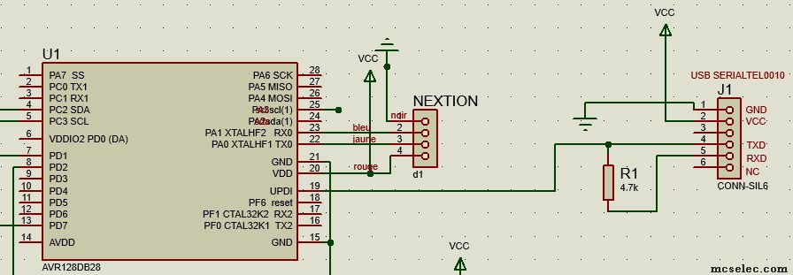

It's is working well for me : CP2102n VCC=5V with filtering/decoupling capacitors 1µf and 10nF

the protection resistor can be 1K. but only function is to protect the TX.
the voltage is also important. try 5V if possible.
and then of course : is the usb power used to power the circuit?
do all gnd and vcc have a connection?
you best provide more details. cp2102 works best for me.

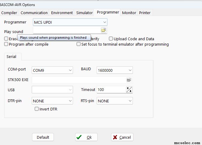

programmista123
Joined: 31 Jan 2018
Posts: 186
PostPosted: Tue Jan 14, 2025 8:27 am    Post subject: Reply with quote
Hi,
Could you share programmer options screenshot?
Do you have any errors?

matjazs
Joined: 08 Nov 2016
Posts: 104
PostPosted: Tue Jan 14, 2025 8:13 pm    Post subject: Reply with quote
programmista123 wrote:
Hi,

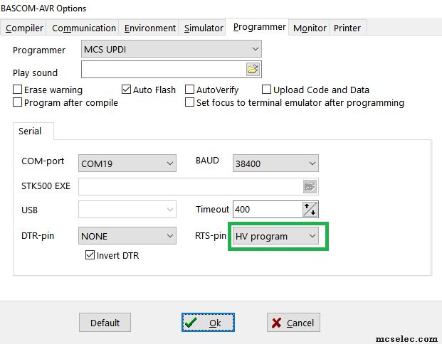

Screenshots are attached. The error is the same with all other option settings (DTR-pin, RTS-Pin >> program/data,HV program, NONE)

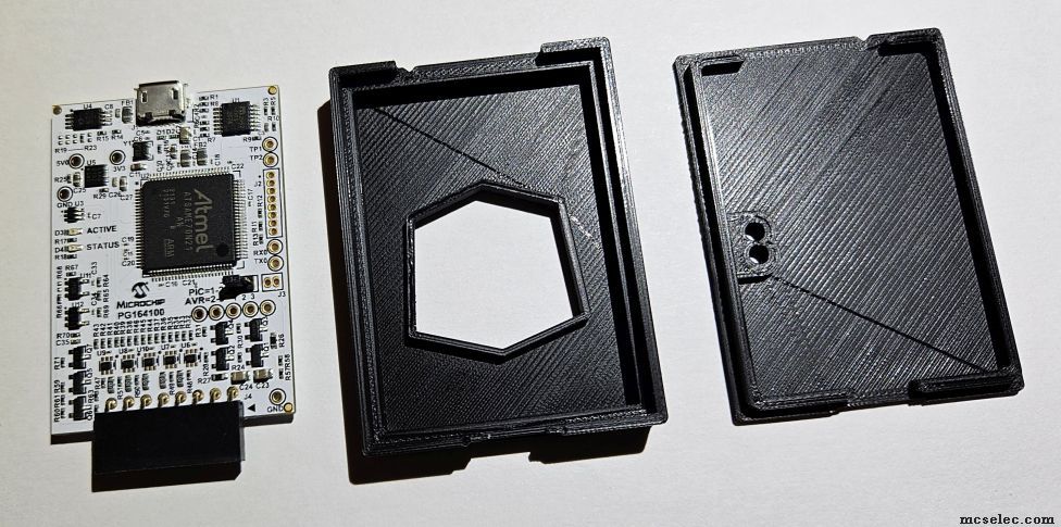

Above Mark asked about the SNAP V1 and V2 VIDs.
I have both SNAP versions.
The new SNAP V2 has a small 3-Pin header on the SNAP PCB.
It is seen in the photo below, just below the microcontroller chip.
Shorting 1 and 2 is for PICs.
Shorting 2 and 3 is for AVRs.
I've used my SNAP V2 for SPI so far, but I've not yet tested it on an Xmega (PDI), or a UPDI chip.

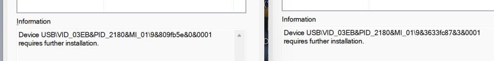

When I plug the V1 and V2 SNAPs into my Windows PC, I see the following VID info in the Device Manager.
The LEFT info is V2, the RIGHT info is the V1 SNAP.
(The 3D case file / design was on Thingiverse, by ariz0na.)

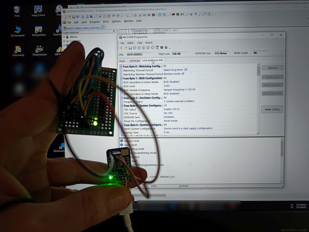

Okay, I got it today. I order it from linked store to be precise.
It is funny for me that it comes with three pin connector JST on the board and four pin plug ahahahaha. So the plug with the wires are useless.
Nomather that I solder a golpin connector (not attached) and connect it to my AVR128DB32 because it is the shortest way to me with this board.
Everything looks like working fine. I can connect and read FuseBits.
I will check the 12V function later.
Please check your connections if you have problem with this adapter. It is working for me.

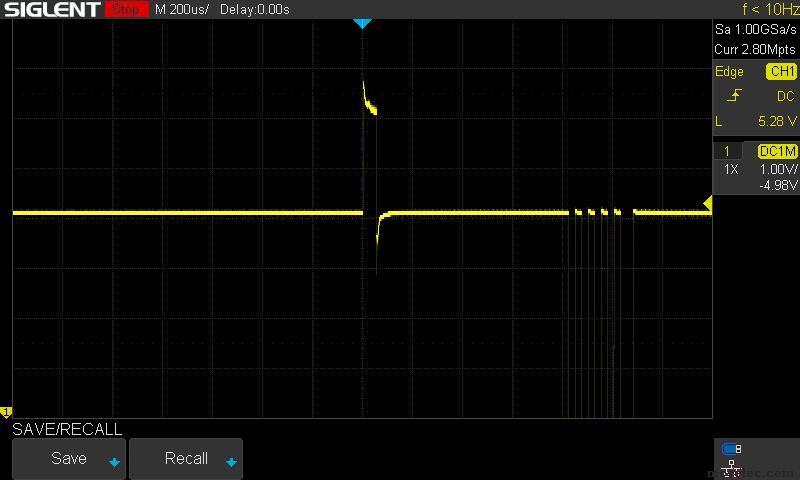

Okay, I test it because Im curious about everything from the birth.
Bascom doing this well. Voltage stays at 5V with this tool.
Only when you config a RTS signal as HV programm then pulse is present at the begining of the sequence.
I set trigger (on oscilloscope) above 5V and rest of communication is 5V-0V shorting to ground.
Now I see that I measure something last time x1 not x10 probe today (This is my fault but not the case here).
