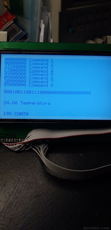

PostPosted: Wed Jul 10, 2024 9:47 pm    Post subject: Reply with quote
This is the situation:
I can partially read the 8 Registers, I can't read the "0" Register, I don't know why:
I can read it but I think it's wrong?
I can't send the command to read it in 16 Bits.
I ask if anyone can help I would appreciate it.

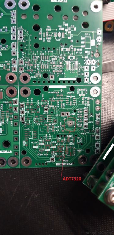

Thanks for the help, however I already have the PCBs made, there are 4 of them, in a sandwich.
I didn't know about this "tmp117" sensor, but it seems good, it works on I2C, which is a problem, I don't like I2C, I avoid doing anything with the I2c protocol.
However, I have a new version, of the routine for the ADT7320, it seems to be better, and from what I measured the temperature value is correct.
Thanks
