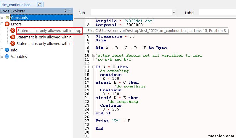

Continue statement is allowed only inside the structure like loop.
Checking this can be made in one minute by testing this code in the simulator.
More curious is the next code. Even if E>0 the loop is never end and nothiung is printed so after Continue E dont get value of 100 and this is what Continue is intended for.

I want to remind that this is the bascom Forum and Bascom statements
So after the help:
CONTINUE must be used inside a DO-LOOP, WHILE-WEND or FOR-NEXT loop.
The code jump is always inside the current loop.
Some times you want to skip some code without leaving a loop and there is Contuine comming to play. But sometimes conditions are match and You can solve this with a GOTO and a label but use of GOTO creates hard to understand code. For this reason some languages have the CONTINUE statement.
