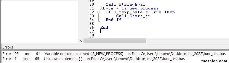

It compile just fine.
Nex time please attach code that can be compiled by simply copy/paste...and remember about brackets.
I also suggest update your Bascom because your version may be not supported Very Happy

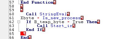

I would complete the function with empty braces.
Posts: 1133
PostPosted: Tue Nov 22, 2022 12:05 am    Post subject: Reply with quote

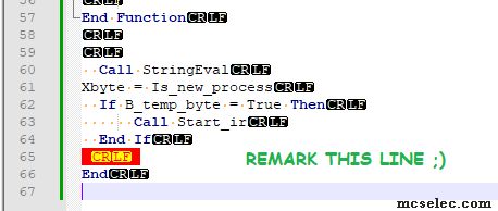

That code had one more flaw.
This probably was from some copying.
If Bascom shows strange errors then you should check copied code in some Notepad++ for incorrect encoding or invisible characters.
So...here you have CRLF but after some weird space. Comment line before the last "END" and code probably compile Wink
BTW. Bascom also have option for that ->Option->Environment->Show Special Characters but maybe this will not be so visible for the first look.

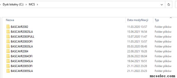

Maybe you should start with update your Bascom.
Download 2085 installer and install it in new folder.
I always do that and have previous for "some reasons"
Here I have "only" from 2082 because i change my computer.

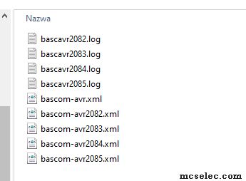

Bascom from some version create separate XML file that can sometimes fix your Bascom installation.
In Bascom IDE you find ->Help ->About ->App data dir.
If you click that link then folder should open and then you must close entire Bascom because those files are keept in the memory and resaved on Bascom close.
So if Bascom is closed then rename your XML into something else like "___bascom-avr2083.xml"
Then if you reopen Bascom then it should be like new.
If that not help then you probably must search problem in your PC.
