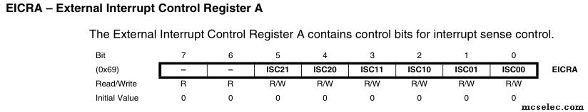

Try get values from sense register EICRA then you`l be shure for something.
Config Int2 = Rising
Dim Helpb As Byte
Helpb = EICRA
Print Bin(Helpb)
This should look like 0011_xxxxx
and it is on My simulation
I think Bascom does it well. Try search something else.

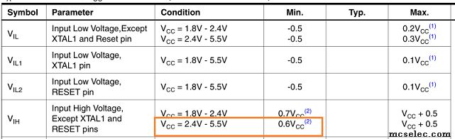

Logic levels is probably your problem. Even though the data sheet says that at Vcc of 5v, 2.6v is treated as logic high and 2.2 is a low, Im wondering if your GPS output is outside this range. Have you tried a weak pullup or pulldown on the mega input that is looking at the GPS signal? What does the pulse look like on a scope?

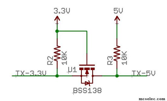

It is a simple matter to use a FET as a logic level shifter. It is bad practice to mix logic levels.

Those are characteristics for Mega324.
0.6Vcc for the 5V power supply not means 0.6V It means 5V * 0.6 = 3V
Some modules have only Open Collector so some pullup must be done but you cant use internal from the Mega because of 5V.
You can try pullup it into 3V3. Or maybe module is 5V I/O tolerant?

Better try simplest level shifter on that one line. There is toons of similar schematics. Search for "level shifter" or "level converter"

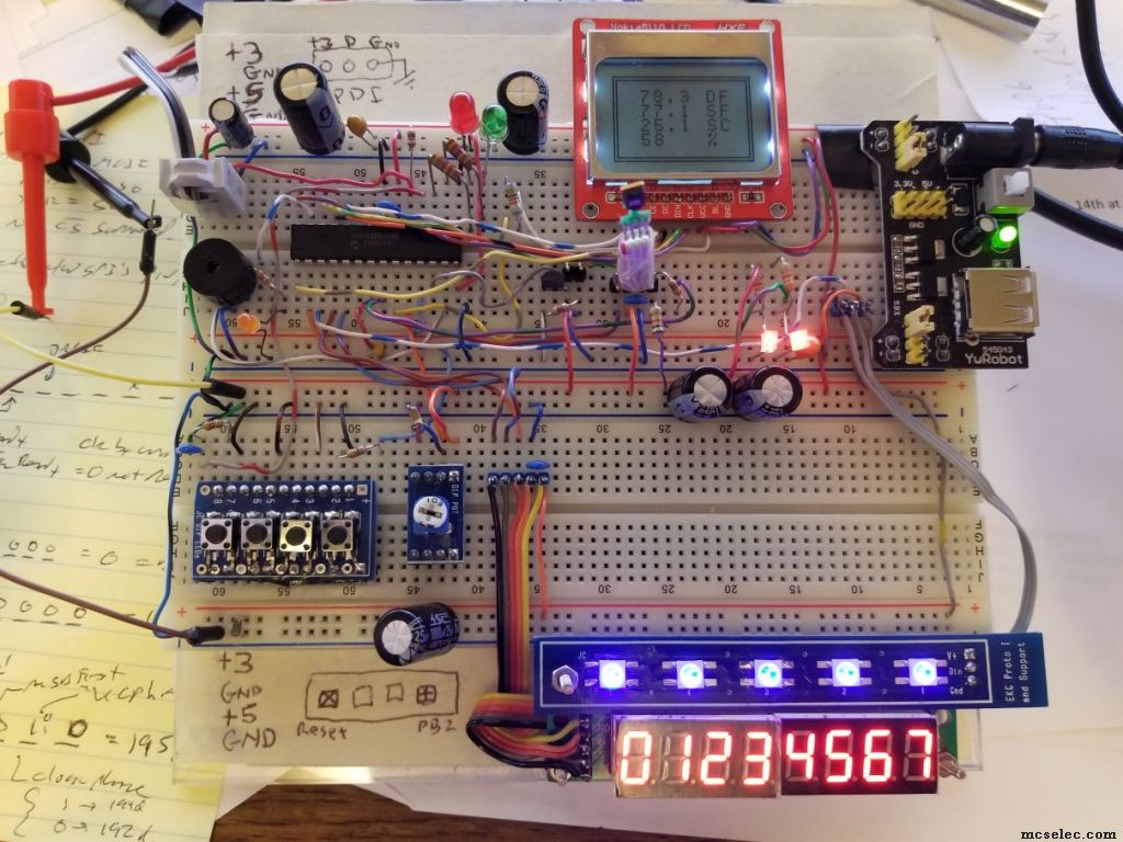

Don't forget that the new AVR DB series also has the ability to run on both 3V and 5V at the same time.
One of the ports can run on 3V, with the chip on 5V, and the level conversion is done for you, inside the micro.
The image below shows several peripherals running on 3V, several on 5V.
GLCD, 7-Seg Display, Dallas Temp, Sensirion Temp and %RH, Digital LEDs, LEDs, Piezo, Pot, etc.
JC
