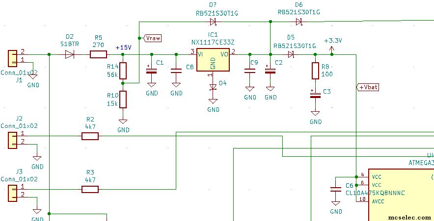

That makes sense. Your suggestion of the Schottky diode is good and I'm adding it to the redesign that I'm finishing now.
I suspect that part of the problem is the choice of voltage sensing point. If, instead, a point upstream of the 3V3 regulator is chosen, suitably divided and clamped to the 3V3 rail, this would provide an earlier signal which would make Powersave happen while the mains supply is still dropping but still holding up the 3V3 rail.
Combined with your delay suggestion I expect a better result with BOD enabled.

My idea is to put the Schottky parallel to charging resistor R8 the direction if charged from IC1, R8 still serves as protection/charging resistor.
As soon supply via IC1 shuts down, the Schottky bridges R8 and allows for less voltage drop if higher currents are drawn from C3.
Agreed.
As you clamp it to VO of IC1, I fear it won't work as supposed.
Imho actual supply voltage VO coming from IC1 has to be the target.
Be aware in active mode VCC of M168 is about 0,22V lower than VO of IC1 because of Vf of D5, equals about 3.1V.

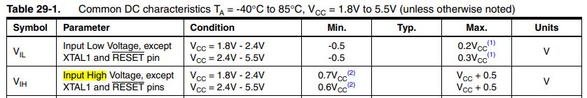

Looked up again pin's threshold voltages, do not remember where I got that 1 Volt from, however in 7530K–AVR–07/14, page 277 it is given for VCC at 3.1V with:
High: 1.6V
Low: 1.5V
With some tolerances - see the datasheet yourself.
I would not use a voltage divider, subtracting a voltage would give a sharper result, which would help to counter tolerances.
What do you think about: IC1/VO --- 1N4148 --- Power_on pin --- pulldown 15k ---GND ?
This would result in:
power-good: >= 2.3V
power-fail: <= 2.2V
At the very moment the controller wakes up by power-good, the real voltage at VCC is 0.22V lower, but already higher than BOD voltage of 1.8V.
A delay may be needless then.

Paulvk - Partly through stubbornness, partly because I want to improve devices that have already been made and partly because the board might sit on a shelf for months before being installed.
O-family - I agree that the BOD is necessary for reliability. I originally believed that the BOD only protected spurious EEPROM writes when values were being written at very low voltages, but it seems that faulty operation can happen at other times too.
I would prefer to keep the reset function in the micro partly because the WD isr can save the current date and time which, although it could end up being a few seconds or minutes out, is still better than starting the clock at midight on Jan 1st 1970.
MWS - that looks like a neat solution, but the thresholds that I saw in the datasheet were, Low - 1V (0.3 x 3V3) and High - 2V (0.6 x 3V3).
IC1-VO = 3.54V (measured) when Vcc is 3.3V, giving the Vf of the Schottky as 0.24V
Assuming a Vf of the 1N4148 of 0.7V, then Vpower_on will always be 0.46V below Vcc, so for a low Vpower_on threshold value of 1V, Vcc will have already dropped to 1.46V
In other words, Vcc would drop below the BOD of 1V8 before the Power_on sense line reached 1V.
Two 1N4148 diodes in series might do the job.

To me, the great advantage of having the Vpower_on sense line come from a 5:1 voltage divider at the input to the 3.3V regulator is that there is early warning of a power cut, allowing the micro to go into Powersave without draining the supercapacitor of any charge. This is because the input to the voltage regulator is still at 5V when the 1V low threshold is reached, telling the micro to go into Powersave.
At 5V input to the regulator, the micro is still being supplied with 3.3V mains power.
When power returns, the supply to the regulator will have already reached 10V when the signal to come out of Powersave (2V on the Power_on input) is triggered.
So, under all conditions, the system is well behaved, being able to shut down early and start up late.
Can't agree on that one, check the diagram, datasheet is version 9365A–AVR–02/16.
If this is your intention, then your schema from 'Sun Jan 23, 2022 2:13 am' is wrong. As you clamp to IC1/VO the higher voltage will prevail, and this is VO and not the weak output from the divider.

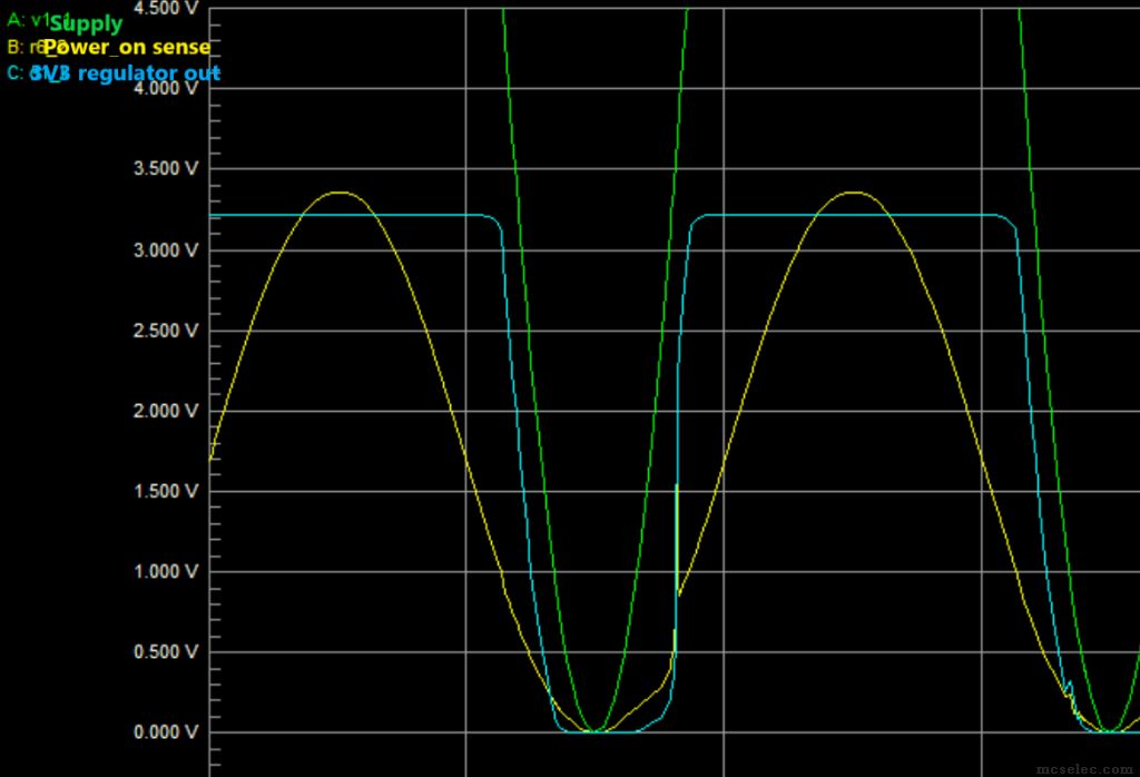

I've done a simulation of the voltages with rising and falling supply levels and you can see that whenever the sense voltage is below the pin change thresholds (rising or falling), the regulator has the full 3.3V output.
Me too.
Your interpretation of your simulation result is wrong.
Check my simulation, white is power_good, green is Vbat to M168.
Vbat is always lower than power_good, results in power good is signaled to early and power no-good too late.
