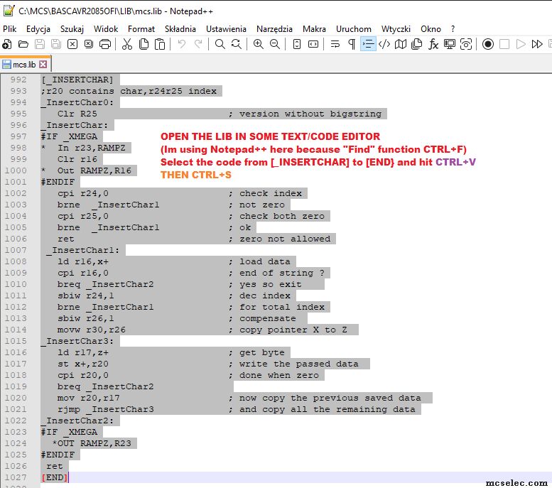

You know what, the Libmanager wants a Text file. So i saved your Assembler code in a Text File and want to Add it to the MCSlib, after i deleted the "old" _Insertchar Funktion.
Posts: 6198
PostPosted: Thu Jan 06, 2022 4:14 pm    Post subject: Reply with quote
you best replace the code with notepad or with bascom editor (make sure lib is not reformatted).
or simply save the routine in notepad with a new name like : "mynewcode.lib"
then use $lib to include this code instead of the code from mcs
but the best way is to used the editor, select the old text, delete it, and then paste the code from this topic.

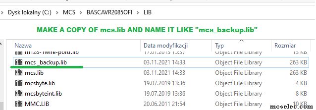

Posts: 1136
PostPosted: Thu Jan 06, 2022 5:36 pm    Post subject: Reply with quote
First step->
You can always back because you have copy Wink
Second step->
Third->
After save you can compile lib with Lib manager. All steps takes about 1min max Very Happy
