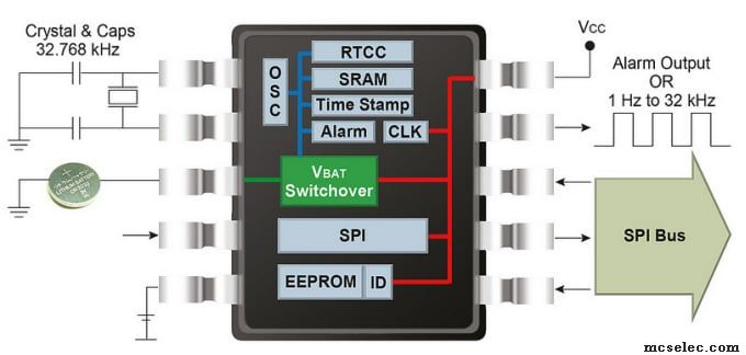

Hello.
This is the basic example of handling this RTC with the Bascom syntax like $Tme & $Date
It work over SPI not I2C.
Chip have 64Bytes of battery keeped/powered RAM and some Eeprom.
It can tell when power was down and when it rise up again.
Ofcourse two alarms are also available.
Can be digitaly calibrated by one register.
