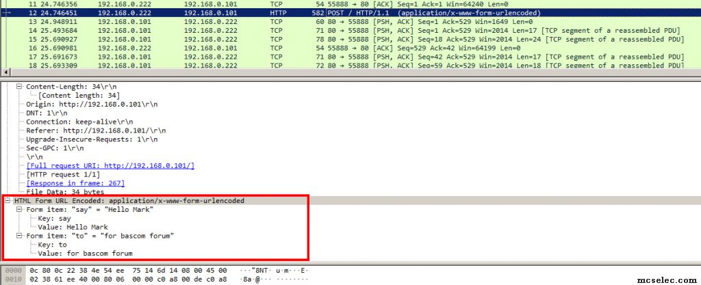

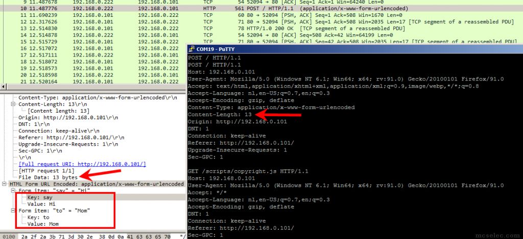

Wireshark shows 13 bytes send and within the putty debug I can see 13 bytes received:
But the content of the 13 bytes somehow get's lost.
At least, within the putty debug i can not find them again.
any suggestions?

I need to clear something up:
Only if I use the POST command the data get's lost.
If I for example use the GET command the input from the webpage is visible in debug because it is placed in the header:

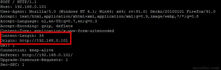

What I don't understand is why I can only read the header of the post command and not the body that contains the actual data. |

i do not know what code you use but after reading the headers you get the size of the data.
then you need to read this data. but this is not string data : it can be any kind of data.
in the webserver sample this code is used:

The POST command contains two sets of data, the header and the body. The header I already could read, but the body containing the data from the page was not read.
And the issue was simple, the body starts with an empty line. And there is the issue.
The loop is stated as: "Loop until S = "" " so it breaks at the empty line. Therefor I could never read the actual data.
