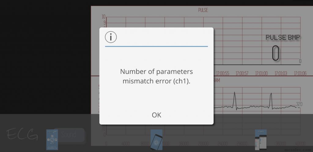

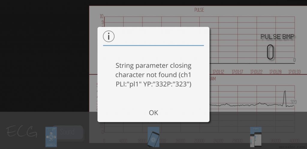

PostPosted: Tue Dec 21, 2021 11:45 am    Post subject: Communication issues Reply with quote
Hello matjazs,
I did the project as well.
Programmed the HC-6 at 19200.
The problem I have is that 99% of the time, on two differnet android phones, I get messages like this one:
[/img]
GUI-O used is the latest version from Google Play Store.
Any suggestion on how to solve this ?
Thank you,
Sergiu

PostPosted: Tue Dec 21, 2021 9:18 pm    Post subject: Reply with quote
Probably the problem is that the initialization didn't go well. This means you need to reset the microcontroller.
The initialization is also incorrect because you did not copy the "ECG.jpg" image file to your Android device.
There may be something wrong with your Bluetooth module. Sometimes it happens that the Bluetooth module cannot send so many bytes in a short time. It happens that some sign is lost. In this case you need to reduce the baud rate to f.e.9600 or add delay between lines (Waitms 10). But this speed (9600) is not recommended for this case (ECG Cardio).
I have the best experience with the HC06 Bluetooth module.
The new version of GUI-O (v0.11.21) offers that you can change double quotes "with others. I used single quotes '. The initialization procedure is now much more readable - you no longer need to write "Chr(34)".
Print "@gse COD:0 TSC:39"                                  'Use ' instead of " (chr(34)
I also add a link the image in the initialization process, which means you no longer have to copy the image to your phone. This image will now be automatically copied from the Internet.
Print "|IM UID:imx X:15 Y:50 W:100 H:100 ROT:0 SHE:0 VIS:1 OPA:1 SCM:2 IP:'https://i.imgur.com/vKnL2LX.jpg'"
Try this new "Cardio1.bas" file, but the old Cardio.bas should work fine too.

Btw, the arduino uno clone I have is working with xtal of 16Mhz so I suppose I need to readjust the Timer1 reload value ?
Sergiu
matjazs
Joined: 08 Nov 2016
Posts: 104
PostPosted: Tue Dec 21, 2021 10:23 pm    Post subject: Reply with quote
Timer is used for BMP calculation and is not a problem for this warnings, but crystal frequency is. You must change it to 16.000000 MHz.
$crystal = 16000000
I use hardware with $crystal = 11059200
