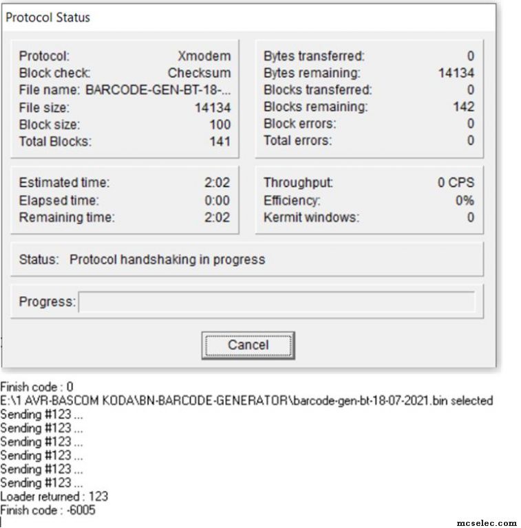

PostPosted: Mon Jul 26, 2021 10:17 pm    Post subject: Reply with quote
Hi!
I have checked bootloader app on a same PC and RS232 cabling with an xmega256a3u board. And it works fine, as it always did.
I have increased $timeout but no success.
However, I did not pay any attenton to the fusses. These are the default values:

Bootloader does respond on "!". Then the timeout error.
See attachement.

PostPosted: Wed Jul 28, 2021 9:23 am    Post subject: Reply with quote
if you call the boot process from the main app there is no need to set the reset vector to the bootloader.
but i would strongly suggest to use the reset vector and use the fuse. when an app is not responding for some reason, there is one thing that will always work : a reset. this can be a simple reset button.
and the idea of the boot loader is that it checks if a character is received and then it starts the process. if not it continue like normal.
an empty chip contains &HFFFF which is also an instruction but does not do a thing. so when you reset the chip it will simply start at address 0000 and then execute this FFFF instruction. then it goes to address 1 etc.
till it runs into the boot loader app.
so when you program a chip the first time with only the loader it will appear to work.
so you always need a test where you load a sample program, and then run the boot loader again.
ok in your case you can not even run the boot loader?
the code you get : possible return codes of the PC bootloader.exe
-6005 Cancel requested
this means the app sends a cancel.
you still did not provide a circuit. just because something else on the port seems to work does not mean it works properly. or that your hardware is ok,

Andro and Mark,
Looking at the output, it does seem as if the Bootloader is responding:
Loader returned: 123
Therefore it seems, this code is executed correctly:
         Print #1 , Chr(bstatus);
         Goto Loader                                        ' yes so run bootloader
But fails after entering the Loader: Do Loop

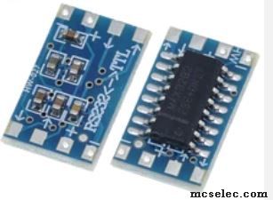

Now I took another HW, this time with FT230XS tied to the COM1 port of the Xmega32E5.
Bootloader works fine now! You were right, Mark. I have to admit, that there was a HW issue indeed.
However, I'm not sure what is the problem - but I asume, the problem is in a cheap MAX3232 china board, that I took with the first HW.
I will do some further test with my own RS232 converter ST3232 or MAX3232, bought at well known EU on-line provider, as I usaualy do.
Sorry for waisting Your time. I'm really ashamed.

PostPosted: Fri Aug 13, 2021 6:28 pm    Post subject: Reply with quote
another mystery solved Very Happy
actually i gave up using cheap parts after finding wires without connections, connectors that did not connect, etc. But when i got fake parts that was the limit for me. it is nice for hobby but not for professional reliable operation.
And long term availability is important too.

A totaly agree, Mark.
The PCB and 100nF caps were fine - but the problem was in MAX3232. When I replaced it with one from Farnell, it works.
I had to make 4 prototype boards, therefore I used this cheap option. And I replaced all 4 MAX3232s.
Again - sorry for waisting Your time.
