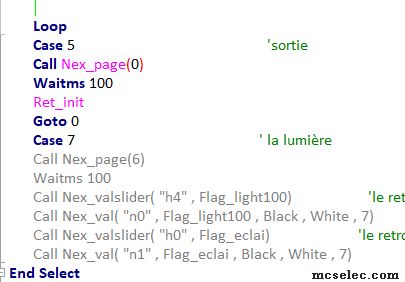

I have a programme that works well, which is a reduction of a much larger programme with a lot of includes that have been removed.
I wanted to add some new procedure call something in a select...case
but these calls remain grayed out, whereas once the program is compiled it works!
the variables flag_light100 =80 and the variable flag_eclai=15
and the result is :
[img]
jp Crying or Very sad [/img]
(BASCOM-AVR version : 2.0.8.4 )

the gray text is dead code coloring. and as written in the help : it is always compiled. Not the be confused with excluded code which is not compiled.
in order to find the problem a sample program that reproduces the problem is required. (i should create a macro since i have asked for this at least 1001 times)
when you use proper indent function and the indention is not correct it points to a problem in the code. this is often simply found with the code explorer.

I found my problem, I can't explain it, I changed a lot of things, simplified a lot and now it works without problem.
