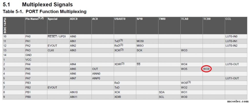

I'm working on my first ATTINY project and can't get the timers to function properly.
I'm trying to toggle an LED every one second (Code A & B), and put a 38KHz 50% wave on another output (Code C).
problem 1:
Code A & B below are alternate ways to blink the LED.
When executed, the LED is high for 1 second then 52.3Khz 50% wave forever after - same result for code A & B.
problem 2:
Code C does nothing (pin stays low). I'm pretty sure this is because I haven't steered the wave output to PA5 (see image below).
The datasheet is unclear how to steer WO0 to PA5 for TCB0. I've looked at the DAT file, Help file and datasheet and can't figure it out.
Any help would be greatly appreciated!

PostPosted: Wed Jul 21, 2021 6:48 pm    Post subject: Reply with quote
1:
you need to reset the timer flag interrupt by writing a 1.
otherwise the timer will not appear again.
see also the help for xtiny
it is similar as in Xmega
3: you need to set the output pin to output mode.
here are some samples, i am not sure if they were included in 2084 release :

jeremywilson
Joined: 11 Jul 2011
Posts: 79
Location: United States
PostPosted: Wed Jul 21, 2021 7:37 pm    Post subject: Reply with quote
Thanks for the response:
1:
Working now.
Config Porta = &B00111010
The bit for PA5 is a 1. That should be an output, no?
I tried using Config PortA.5=output to no avail.
View user's profile AIM Address
PostPosted: Wed Jul 21, 2021 7:50 pm    Post subject: Reply with quote
yes that should be an output but check the second example where both low and high registers are written in one go using overlay.
jeremywilson
Joined: 11 Jul 2011
Posts: 79
PostPosted: Wed Jul 21, 2021 8:43 pm    Post subject: Reply with quote
All good now ! Many thanks !
I never would have figured out the overlay thing. I use interrupts frequently on ATMega2560/1 and often write low and high register bytes separately and never had an issue.
