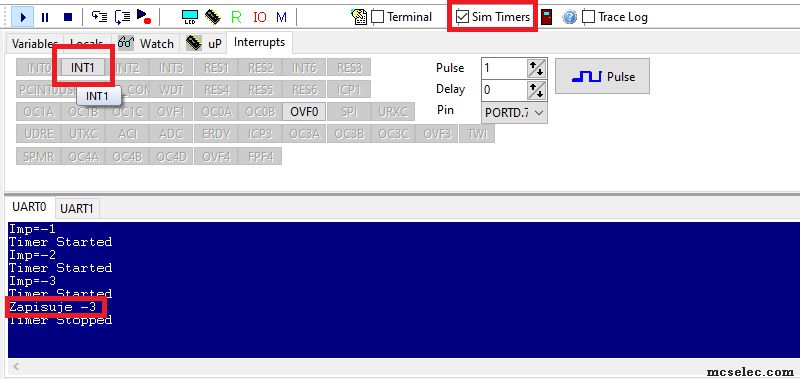

It can be easly tested in the simulator. HWSTACK is too low. Also "Set Chb" does nothing because you can`t write into PIN register. Try "Portd = Portd Or &B0000_0011 "
Code for simulator below. Enable "Sim timers" and hit couple of times INT1 on Interrupts tab.
If HWSTACK will be 30 then everytime "Zapisuje -1". If HWSTACK is larger then "Zapisuje -3 ... etc."
You have over >2KB SRAM on it. Why not use it for increase stacks? Very Happy

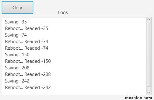

Code slightly modified for clarity and working just fine.

Print "Reboot... " ;
Impulsy = Read_from_eeprom()

I found the cause but don't know yet why. After reseting Micro (button push) I have to disconnect usb (one as a power) and second usb where is my uart-usb converter. Also close Bascom terminal. Then connect both usb and open terminal. Then everything works. It seems strange this Micro to me (the way I have to deal with).
Thank you EDC and MWS.
