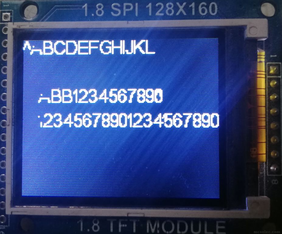

Τhe result is very good but i have a problem.
The first character of every string is broken.
I also tried different font files with the same problem.

I can't reproduce this behaviour, could you upload a complete sample (incl. fonts) which shows that?

PostPosted: Sun Jun 06, 2021 12:28 am    Post subject: Reply with quote
In the Pset-Routine resp. the _convert_color1 routine called from there the memory positions in the softstack Y+5 and Y+6 get trashed, which contains the pointers to the frame space for local variables.
I don't think this is intended behaviour, maybe o-family can help there.
This saves/restores the memory positions prior/post calling Pset as a temporary fix (in ProportionalFont.inc, line 193):

After a long time with health problems I have returned to thank Netzman for the answer.
All characters is OK but now I am confused with other problem.
How can I replace a letter of a word with a new one without use CLS command?
Now the new letter is printed on the old one with Lcd_tt_text command.
