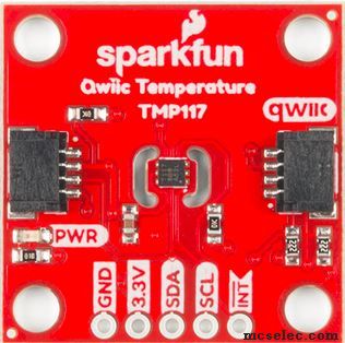

not : the tmp117 is placed in the centre of the circuit and therefore difficult to put it in contact with a part to control the temperature.
With a little searching, one can find a better constructed circuit where the tmp117 is placed on top of the circuit.
