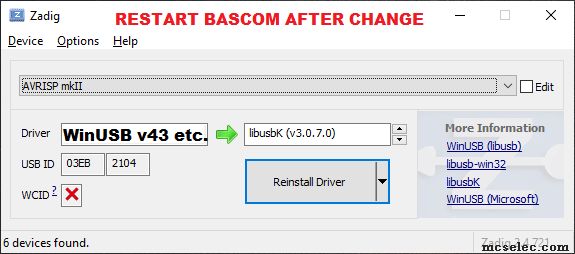

(The only problem I've encountered, and never finished tracking down, was trying to get my AVR ISP mkII programmer to work from within Bascom.
There is info on how to configure the Window's drivers, etc., for that, but I just use a different program to download the hex file.)

@JC Replace with Zadig newest Windows Winusb v43 driver for MKII with this showed on the screen Wink
I must do this every Win10 update ... so today I take a screenshot. Enjoy Very Happy
En voila!
Posts: 1197
PostPosted: Tue Apr 20, 2021 11:41 am    Post subject: Reply with quote
thanks for this good news : I can use my MKII now

PostPosted: Tue Apr 20, 2021 9:08 pm    Post subject: Reply with quote
EDC,
Thank you!
I appreciate the help!
JC
