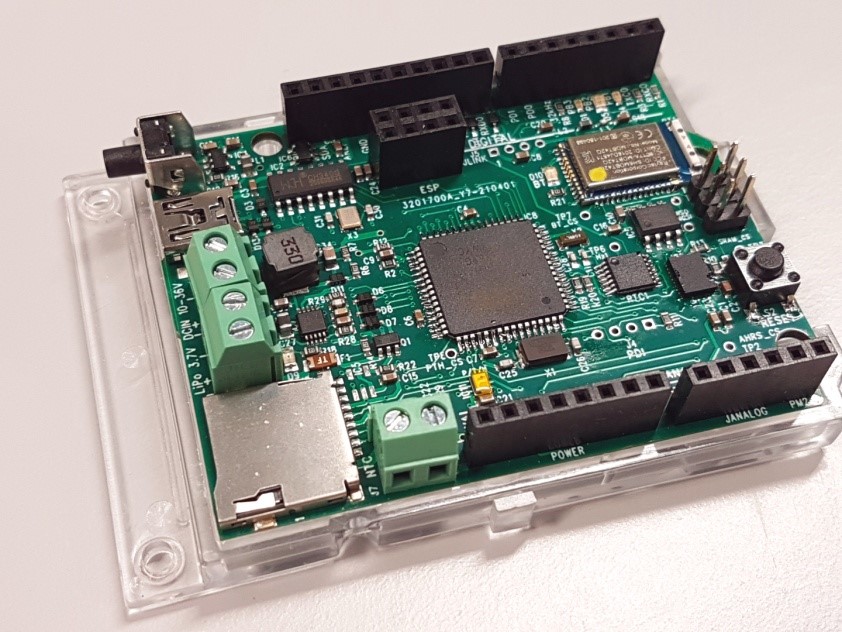

The latest news is that I made this Xduino board come true after all !
You can read more about it if you look at [url] https://www.mcselec.com/index.php?option=com_content&task=view&id=427&Itemid=41[/url] on MCS home page.
The whole idea of this board is to show what we can squeeze out of a board running Bascom code.
There will be more information coming quite soon. Either in this thread or in a new forum subject.
Stay tuned !
/Per

Interesting why not go to the blog section and make a project blog
I would have put a ESP32 on the board giving wifi and blue tooth
Regards Paul
