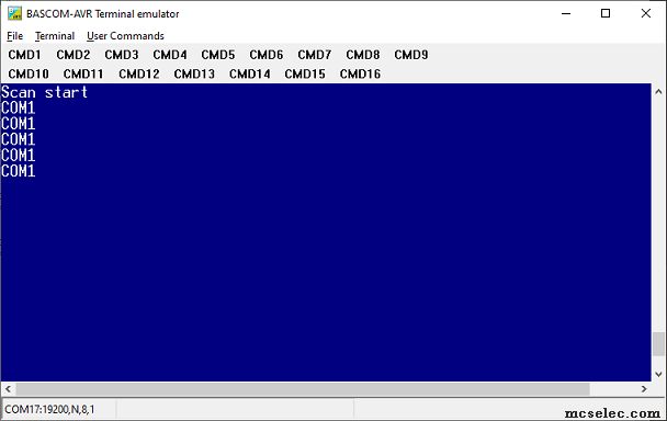

Why not to ground pin 21 on the schematic?
Your code copied from this forum is working -> see pics.
